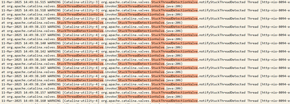

Confluence Data Center (DC) version experienced a service interruption during the page replication p
chunxiao guo
March 12, 2025
In the logs, the `StuckThreadDetectionValve` was triggered, all related to the action of replicating the page. It is highly likely that this caused the issue, but it's unclear why the page replication triggered a thread blockage.111.png
Additionally, after I restarted one of the nodes in Confluence Data Center (DC), I noticed a slow query in the database. I'm not sure if this is normal.
