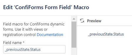

I tried using the "_previousState" function mentioned in the link you shared, to add from which Status is the request transitioning to. So I simply added "_previousState.Status" in the Field Name for a Form Field Macro to reference the previous state as you can see below.
Now it did work correctly but since the Status field in my form uses the "Status" field type itself which at the back end is saved using its constant value (i.e. - red is "error", green is "success"), the "_previousState" function displays the constant value and not the actual value of the field.
In the below example, I transitioned the status from Completed (green i.e. success) to Open ( red i.e. error). But in the final example as you can see, the previous state shows the constant value and the normal field works correctly. Is there anyway to fix this?

_previousState is available only in IFTTTs.
There is no previous state when record's data is rendered.
Only when it is changed and at the moment it was changed. So it means it is either in IFTTT conditions or in Field Definition Rules
