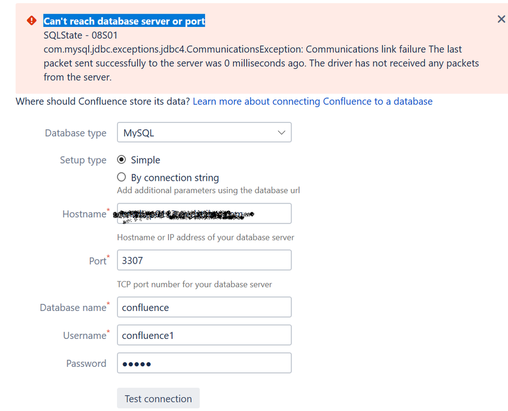

When I set confluence to connect mysql, it shows me this below error:
both Mysql and confluence are installed by docker in a same server, and set mysql with port 3307(docker run -p 3307:3306)
I have create DB confluence with "grant all" user confluence1 and pw 54321.
and set wait_timeout = 600 in my.cnf but still no use
Does anyone have ideas about it?
Thank you.

Hi @Zhi Tian Liao
The communication link between the driver and the data source to which the driver was attempting to connect failed before the function completed processing. So usually its a network error.
Can you please try to create the database connection using the Connection string option.
Follow the below details and replace the value based on your instance.
Connection string: jdbc:mysql://[Host IP or DNS]:[PORT]/[Database Name]?sessionVariables=tx_isolation='READ-COMMITTED'
Driver class: com.mysql.jdbc.Driver
Driver JAR location: atlassian-confluence/lib/mysql-connector-java-5.1.48.jar
Username:XXX
Password:XXX

Hello Manisha
Thanks for your replies
I've checked my network, idk why docker cannot connect with Host IP and port, but can be connected with other servers. I try to connect with docker IP and infra port and it works now.
