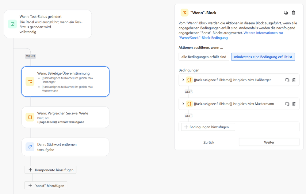

I'm having trouble executing the automation shown below.
As there seems to be no way (without access to extensions) to compare the person assigned to a task (upon completion) to a certain group of people, I had to create an automation similar to the one shown.
I am running several of these rules for each department in order to test which department a task was assigned to.
The issue appears only in one of these rules so far and seems to stem from the "ß" in the first name I am testing for.
For privacy's sake the names are fake.
There seem to be no issues with umlauts. They work fine. But the "sharp s" aka "ß" doesnt seem to work.
I recreated to the whole rule from scratch for troubleshootings sake - no change
I changed the lettering from "ß" to "ss" in hopes it would work - no change
I tried the other people of the same group (and thus falling under the same automation rule) and that worked.
Does anyone have a solution for this?

There are at least two open defects for automation rule conditions not functioning correctly for values in languages such as German:
https://jira.atlassian.com/browse/AUTO-694
https://jira.atlassian.com/browse/JIRAAUTOSERVER-306
I recommend working with your Jira Site Admin to contact the Atlassian Support team to learn if there are any workaround for these defects: https://support.atlassian.com/contact/#/
When you hear back from them, please post what you learn to benefit the community.  Thank you!

In this case the error was on my end it seems and not caused by the special character after all.
