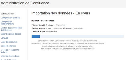

Hi,
I tried to migrate confluence from the cloud to the servers
I did a backup with no attachments and when I start restoring the data it crashes after a few minutes (the database is on SQL Server 2014 SP2, confluence is installed on linux)
Here is the error that I have in the log
 2017-05-29 15:22:30,519 ERROR [Long running task: Importing data] [confluence.importexport.xmlimport.BackupImporter] importEntities Cannot import the entities:
-- url: /longrunningtaskxml.action | referer: http://localhost:8090/admin/restore-local-file.action | traceId: f3fa46027d449cf0 | userName: admin | action: longrunningtaskxml
com.atlassian.confluence.importexport.ImportExportException: Unable to complete import: Error while importing backup: not-null property references a null or transient value : com.atlassian.confluence.setup.bandana.ConfluenceBandanaRecord.key
at com.atlassian.confluence.importexport.xmlimport.DefaultXmlImporter.doImport(DefaultXmlImporter.java:64)
Caused by: org.xml.sax.SAXException: Error while importing backup: not-null property references a null or transient value : com.atlassian.confluence.setup.bandana.ConfluenceBandanaRecord.key
net.sf.hibernate.PropertyValueException: not-null property references a null or transient value : com.atlassian.confluence.setup.bandana.ConfluenceBandanaRecord.key
at com.atlassian.confluence.importexport.xmlimport.parser.BackupParser.endElement(BackupParser.java:45)
at org.apache.xerces.parsers.AbstractSAXParser.endElement(Unknown Source)
at o

AnnWorley
May 30, 2017
It looks like the error is similar to the one described in XML import fails due to error: not-null property references a null or transient value
From the log snippet, you have an issue with the bandana table rather than the links table. The knowledge base article recommends running some queries on the source database, which is Cloud in your case. The Atlassian Cloud support team can run the queries for you as you won't have access. Please open a ticket at https://getsupport.atlassian.com.
