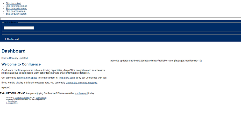

After migration all pages are missing, layout is broken as well as CSS.

When I reboot the server or manually (gracefully) stop the service (via services.msc) and the start the service the site gets corrupted/broken (like on the screenshot)
