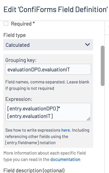

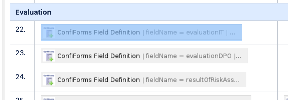

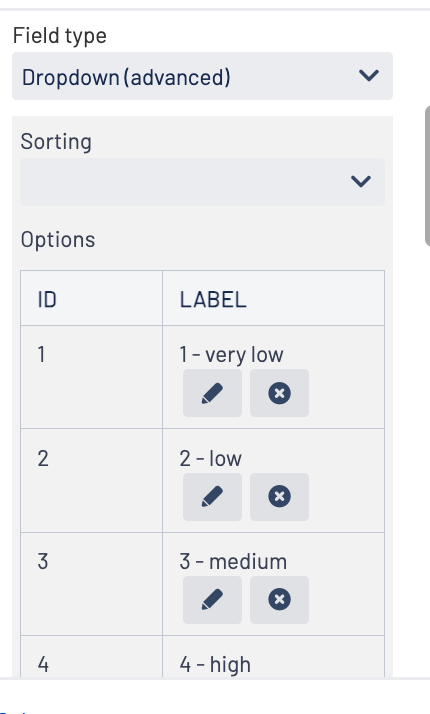

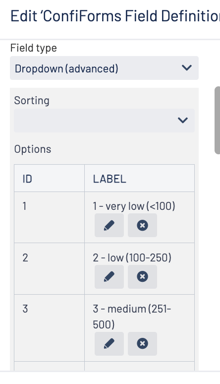

Hi @Alex Medved _ConfiForms_  I am getting this error:
Expression: [*] could not be calculated, Too many operators or functions at: *
and in some of the entries a 2 appears:
Expression: [*2] could not be calculated, Too many operators or functions at: *
The expression is quite simple and in some of the entries it works. The form itself is quite long, but the calculated field is only a multiplication between two fields:
Then for evaluationIT we have:
Then for evaluationDPO we have:
And finally the calculated field is:
April 23, 2024
I believe what you are looking for is actually a formula field, not calculated - unless you want to calculate this only once, on record creation, and never recalculate
And to handle empty values, as explained in the comments here you will need to wrap the field values in the ZEROIFEMPTY functions
ZEROIFEMPTY("[entry.evaluationDPO]") * ZEROIFEMPTY("[entry.evaluationIT]")

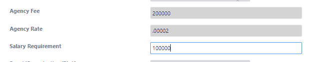

Hey @Alex Medved _ConfiForms_ , I am having an issue converting this to multiplicative form.
I have the following built with the following formula
MasterTechAgencyFee=ZEROIFEMPTY("[entry.MasterTechAgencyRate.masterpickagencyagencyrate]")*ZEROIFEMPTY("[entry.MasterTechAgencySalaryRequirement]")
Where the Agency Rate field is a smart field reference to another form (i.e. why I have .masterpickagencyrate on the end)
this should be providing an answer of 2 (100,000*.0002) but is instead providing 200,000 as the the answer.
March 21, 2024
Sorry, but please provide a mathematically valid number - 0.0002
David C
March 21, 2024
I'm attempting to multiply it by 20% (however.02 also did not work), (20%*100,000=20,000). I'm unsure of how .00002 is not a mathematically viable number?
March 21, 2024
instead of .00002 put 0.00002
David C
March 21, 2024
Thanks as always Alex, that seemed to do the trick.
