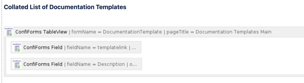

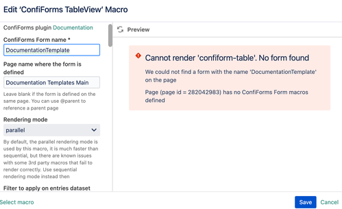

I define the form on page B (above) and I try to collate them using ConfiForms TableView and input the page location in "Page name where the form is defined" I select the page suggestion I want- Page A (Documentation Templates Main). I get this error aler t below:

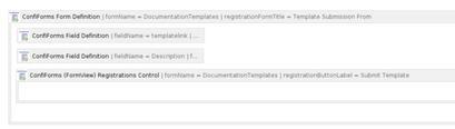

Can I not simply generate the form results on another page using the ConfiForms TableView? Am I doing this wrong?

You have DocumentationTemplates (plural) form on the page A, but you reference a DocumentationTemplate form on the page B

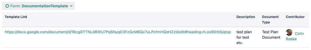

Hi again @Alex Medved _ConfiForms_ - quick question: Any idea on how to adjust the column width or constrain it. Currently, the link pushes the width out as wide as the number of link characters until there is a space. This is in ConfiForms TableView’ Macro. Maybe CSS is needed?

You can try with fixed width table https://wiki.vertuna.com/display/CONFIFORMS/How+to+create+a+table+with+fixed+width+columns+in+Confluence+with+ConfiForms
Or creating a link with a asLink function, as per https://wiki.vertuna.com/display/CONFIFORMS/Virtual+functions giving it some label to make it shorter
Colin Roeke
September 22, 2023
Thanks for the link. That was the direction I needed. Didn't quite work so I instead used word-break: break-all; because of the link in the field not breaking in the fixed width column. working now. Thanks!
