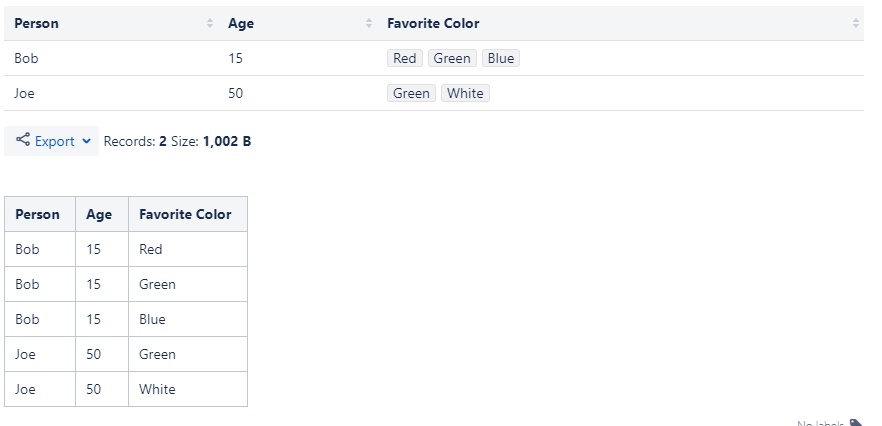

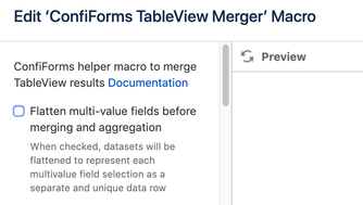

Probably you can just use the ConfiForms TableView Merger macro and set the parameter to "flatten entries"

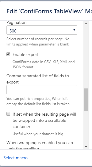

After thinking about it a bit there is a way to show it as a table on a page. You can get the URL for the flattened CSV file from the method above. It would look like this ...
https://{your server}/ajax/confiforms/export.action?t=flatten.csv&pageId={your page id}&fd={your form name}%3A{your page id ... again}&fields={field 1}%2C{field 2}%2C{field 3}%2C{field n+1}&filter=
From there you could use a user macro that I wrote a couple of years ago to display the CSV as a table. The user macro code is below. Also there is and example screenshot of what it looks like. The top table is the TableView macro and the bottom table is the flattened CSV version of that table displayed via the user macro.
