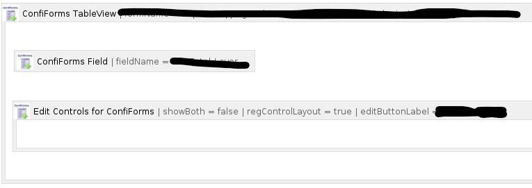

In the system we use TableView and Edit control - Edit record button for a summary list, and for expense calculation we use ConfiForms rules for field definition like below:
ConfiForm Field: Total

And the summary list use TableView, ConfirForms Field and Edit control as attachment.

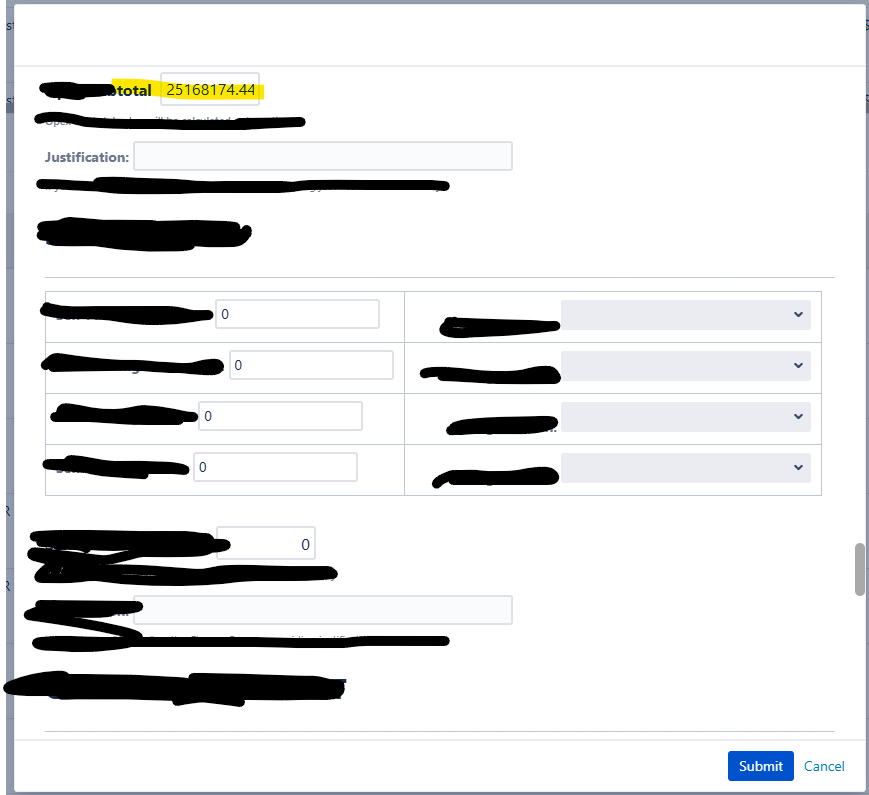

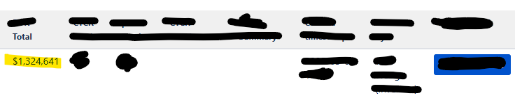

The total number in TableView would be different from in the dialog window in Edit Control, but the ConfiForm Field is the same. In TableView it is correct, and don't know why in Edit control rendering it becomes a large number which we also don't know how it came up. Sanpshots are as below attachment.

TableView, ConfiForm Field and Edit control structure:

number in TableView and in Edit Control is different. In TableView it is correct, and don't know why in Edit control rendering it becomes a large number which we also don't know how it came up.
Alex Medved _ConfiForms_
July 17, 2025
Most probably your rule is set to run on form load and not only on user action - which makes it run for 3 times, as it is set to be on 3 fields.
You can enable debug mode for the ConfiForms FormView Registrations Control macro to see which rules gets triggered and in what order. But I believe that setting the rule to trigger on user action only (parameter in the ConfiForms Field Definition Rules macro) will fix the problem
