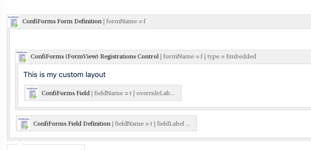

I've created a custom-layout form using ConfiForms, which is working fine for data entry. I would like to allow users to update their record using the same form. I thought I could use a link, containing the entry's ID to allow it to pull up the record, but the examples I've found so far seem to be limited to standard views. Is this possible? Thanks!
Alex Medved _ConfiForms_
January 12, 2023
Hi @Mark and welcome to this community
Have answered this in our (private) support queue, but will also answer it here - as may be it will be helpful to others
Your ConfiForms (FormView) Registrations Control macro must be inside the ConfiForms Form Definition macro in order to “define“ a default layout

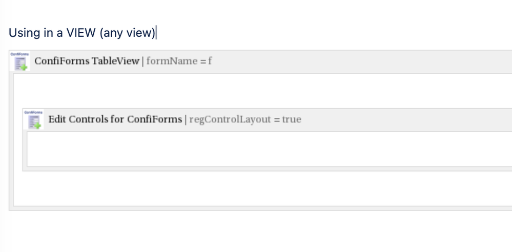

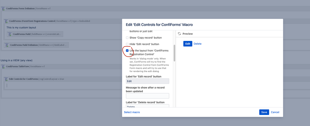

When that is the case you can then have a ConfiForms Edit Controls macro to have this option enabled
Here are some screenshots to demonstrate this visually using macro configurations
Alex

You should be able to point the Edit Controls to use the "Registrations Control" layout
True that it will still be presented in a dialog
