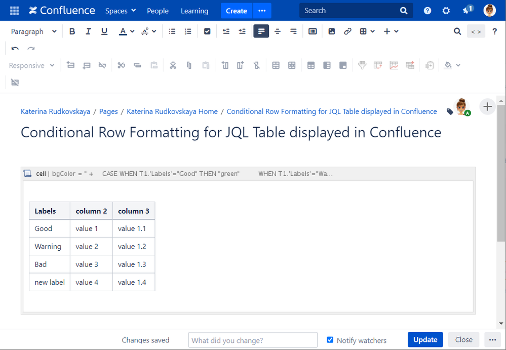

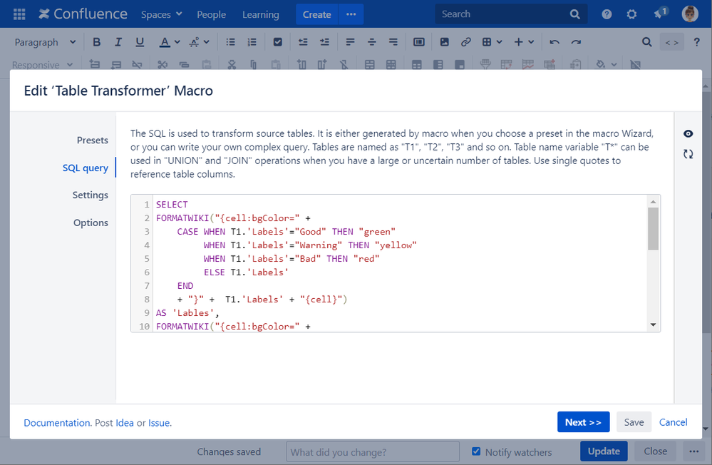

Hello @Tonja Davis ,
Please wrap your source table with Table Transformer and use the SQL query like this:
SELECT
FORMATWIKI("{cell:bgColor=" +
CASE WHEN T1.'Labels'="Good" THEN "green"
WHEN T1.'Labels'="Warning" THEN "yellow"
WHEN T1.'Labels'="Bad" THEN "red"
ELSE T1.'Labels'
END
+ "}" + T1.'Labels' + "{cell}")
AS 'Lables',
ELSE T1.'Labels'
END
+ "}" + T1.'column 2' + "{cell}")
AS 'column 2',
ELSE T1.'Labels'
END
+ "}" + T1.'column 3' + "{cell}")
AS 'column 3'
FROM T*

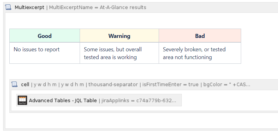

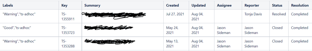

Tonja Davis
August 4, 2021
My problem is I am not wrapping a Wikitable. I'm wrapping another macro (Advanced JQL Table) in Table Transformer and trying to parse information from Advanced JQL Table as conditional formatting for the cells
I've expanded the SQL you gave above to include all of the cells that are displayed but I get an error when implementing the SQL even though it's formatted properly. The table displays but none of the cells are properly colored

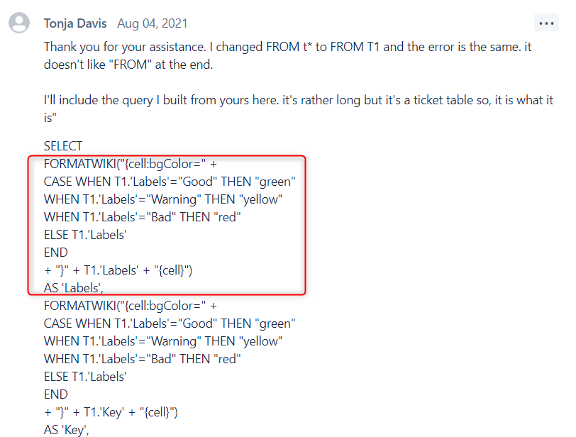

Tonja Davis
August 4, 2021
Thank you for your assistance. I changed FROM t* to FROM T1 and the error is the same. it doesn't like "FROM" at the end.
I'll include the query I built from yours here. it's rather long but it's a ticket table so, it is what it is"
SELECT
ELSE T1.'Labels'
END
AS 'Labels',
ELSE T1.'Labels'
END
+ "}" + T1.'Key' + "{cell}")
AS 'Key',
ELSE T1.'Labels'
END
+ "}" + T1.'Summary' + "{cell}")
AS 'Summary',
ELSE T1.'Labels'
END
+ "}" + T1.'Created' + "{cell}")
AS 'Created',
ELSE T1.'Labels'
END
+ "}" + T1.'Updated' + "{cell}")
AS 'Updated',
ELSE T1.'Labels'
END
+ "}" + T1.'Assignee' + "{cell}")
AS 'Assignee',
ELSE T1.'Labels'
END
+ "}" + T1.'Reporter' + "{cell}")
AS 'Reporter',
ELSE T1.'Labels'
END
+ "}" + T1.'Status' + "{cell}")
AS 'Status',
ELSE T1.'Labels'
END
+ "}" + T1.'Resolution' + "{cell}")
AS 'Resolution',
ELSE T1.'Labels'
END
FROM T1

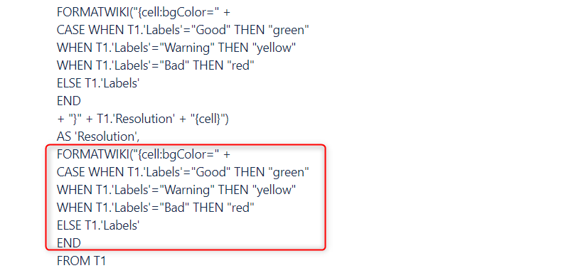

Katerina Rudkovskaya [Stiltsoft]
Atlassian Partner
August 5, 2021

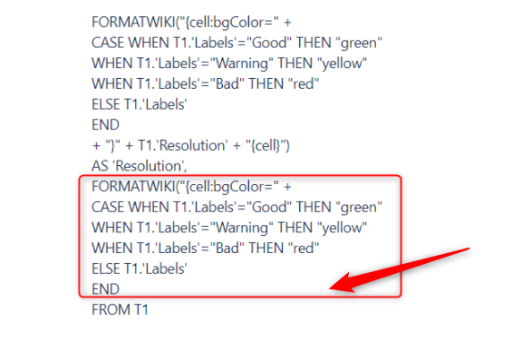

Note that you are using this part of the SQL query twice:
ELSE T1.'Labels'
END
Please try to delete one of them.
Katerina
Stiltsoft
Tonja Davis
August 5, 2021
Thank you for your help. I did as suggested and - on the upside - the error is gone.
On the downside, The table is rearranged (minor issue that is not critical) but the cells are also not colored. For transparency, I deleted the one at the bottom (right before "FROM T1" I will try again deleting the one at the top
Tonja Davis
August 5, 2021
deleting the one at the top results in an error. the one at the bottom is the best one to delete.

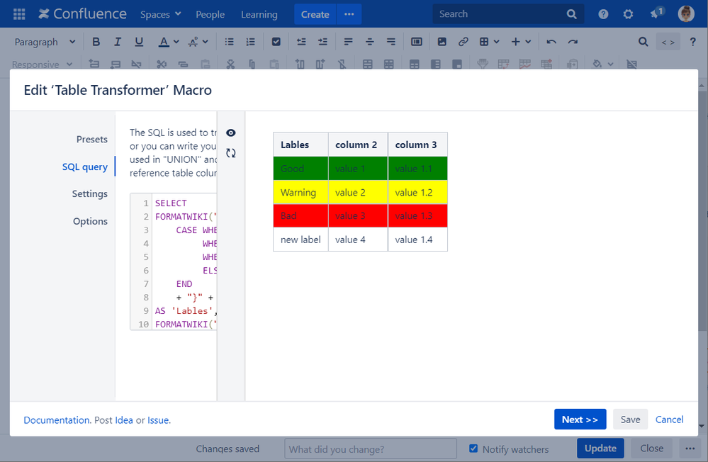

Atlassian Partner
August 5, 2021
Yes, it's because the second part is not the full written part of the query.
I use this query and colors apply:
SELECT
ELSE T1.'Labels'
END
AS 'Key',
ELSE T1.'Labels'
END
AS 'Summary',
ELSE T1.'Labels'
END
AS 'Created',
ELSE T1.'Labels'
END
AS 'Updated',
ELSE T1.'Labels'
END
AS 'Assignee',
ELSE T1.'Labels'
END
AS 'Reporter',
ELSE T1.'Labels'
END
AS 'Status',
ELSE T1.'Labels'
END
AS 'Resolution',
ELSE T1.'Labels'
END
AS 'Labels'
FROM T1
Please copy and paste it into Table Transfromer.
