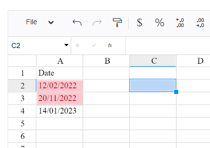

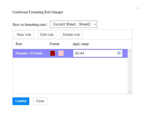

Here is how your condition works for me (the app version is 9.5.2, today is 2/12/2022):

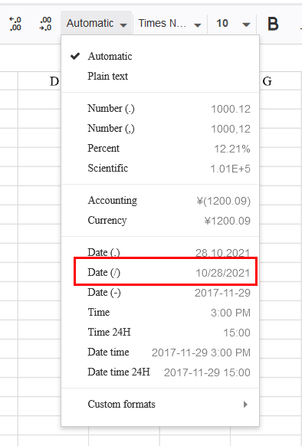

Even if there is this match, you might check if your formula is working after you set the particular column to the appropiate date format just in case your data is not automatically recognized.
