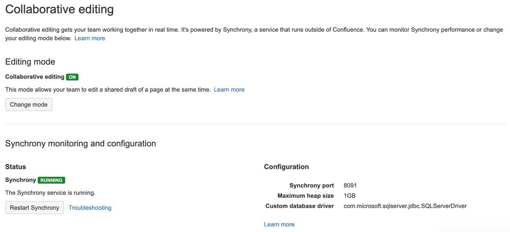

As an admin to the confluence instance, can you check if the Collaborative editing feature is running?
To confirm, go to Confluence Administration --> Collaborative Editing --> verify the Editing mode and Synchrony Status.
If the status shows as above, then we can rule out the issue is not with Collaborative Editing, else we need to resolve the Synchrony issue by reviewing the Home directory logs.
<Confluence_Home _directory>/logs/atlassian-confluence.log

Looks like Editing is on and Synchrony is running.
I'll coordinate with my system admin to get access to the logs. Thanks for your help.
