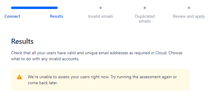

ASSESS AND PREPARE YOUR USERS
When trying to assess and prepare the users I get an error:
I used the same user (email) on-prem and in the cloud. They are admins on both sites.
Furthermore it sometimes throws this exception in the catalina.out a while after clicking to beginn the assessment:
Exception in thread "com.atlassian.migration.agent.service.analytics.AnalyticsEventService:thread-46" com.atlassian.migration.agent.service.encryption.exception.EncryptionException: Encryption Config has gone corrupt
at com.atlassian.migration.agent.service.encryption.EncryptionConfigHandler.getKeyLocationFromConfig(EncryptionConfigHandler.java:60)
at com.atlassian.migration.agent.service.analytics.AnalyticsEventBuilder.buildCompletedInstanceAnalysisAnalyticsEvent(AnalyticsEventBuilder.java:495)
at com.atlassian.migration.agent.rest.StatisticsResource.lambda$getServerStatistics$0(StatisticsResource.java:55)
at com.atlassian.migration.agent.service.analytics.AnalyticsEventService.lambda$saveAnalyticsEventAsync$0(AnalyticsEventService.java:75)
at com.atlassian.migration.agent.service.analytics.AnalyticsEventService.lambda$saveAnalyticsEvents$1(AnalyticsEventService.java:80)
at com.atlassian.migration.agent.logging.LoggingContextAwareExecutorService.lambda$execute$3(LoggingContextAwareExecutorService.java:104)
at java.base/java.util.concurrent.ThreadPoolExecutor.runWorker(Unknown Source)
at java.base/java.util.concurrent.ThreadPoolExecutor$Worker.run(Unknown Source)
at java.base/java.lang.Thread.run(Unknown Source)
Caused by: java.lang.NullPointerException
at com.atlassian.migration.agent.service.encryption.EncryptionConfigHandler.getKeyLocationFromConfig(EncryptionConfigHandler.java:58)
... 8 more

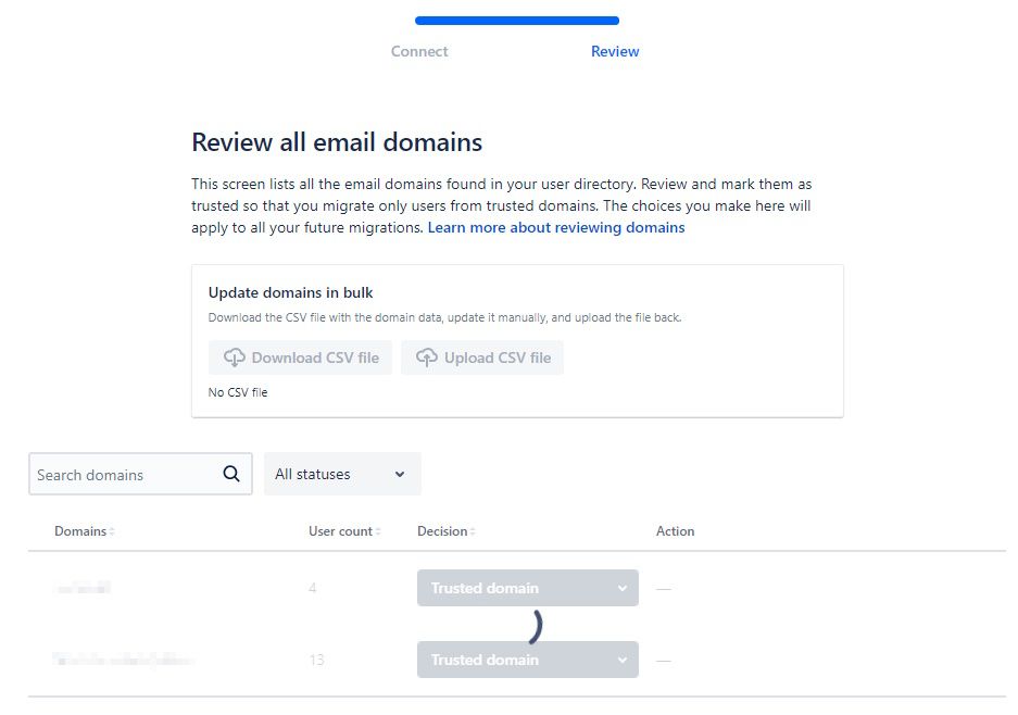

REVIEW ALL EMAIL DOMAINS
When I click on review all email domains this starts to turn perpetually:confluence-bug.jpg
Yesterday I managed to select the domains as trusted, however that does not change anything.
While this is working in the GUI these warnings get reported in catalina.2024-01-11.log (I redacted the server name and GUID):
11-Jan-2024 13:44:35.639 WARNING [Catalina-utility-2] org.apache.catalina.valves.StuckThreadDetectionValve.notifyStuckThreadDetected Thread [https-jsse-nio-8091-exec-24] (id=[284]) has been active for [60,505] milliseconds (since [1/11/24 1:43 PM]) to serve the same request for [https://***.local:8091/rest/migration/latest/email/blocked-domains/<GUID>] and may be stuck (configured threshold for this StuckThreadDetectionValve is [60] seconds). There is/are [1] thread(s) in total that are monitored by this Valve and may be stuck.

I hope someone recognizes these problems and can help me resolving them.
Thanks and greets!

Hi all,
I was able to fix the problem. Both problems occurred because of SSL inspection on our firewall and because the CA Cert, that was rolled out, isn't trusted by the JVM by default. I excepted the 2 domains, that it showed in MIGRATE YOUR DATA after creating a migration in the pre-migration checks.
Here are the domains:
https://rps--prod-east--app-migration-service--ams.s3.amazonaws.com
https://rps--prod-west2--migration-catalogue--migration-storage.s3.us-west-2.amazonaws.c

I searched in the community and found this article as it appears something may be stuck on your server: stuck threads
I didn't see any articles about the corrupted encryption.  You could try opening a ticket with Atlassian Support and select 'Migration support'
Hope that helps
Atlassian Admin
January 12, 2024
Hi,
I don't think that's the cause of the stuck thread as it only appears when I start assessing the emails.
Unfortunately I can't add a ticket as we only have starter licenses.
Thanks and greets
