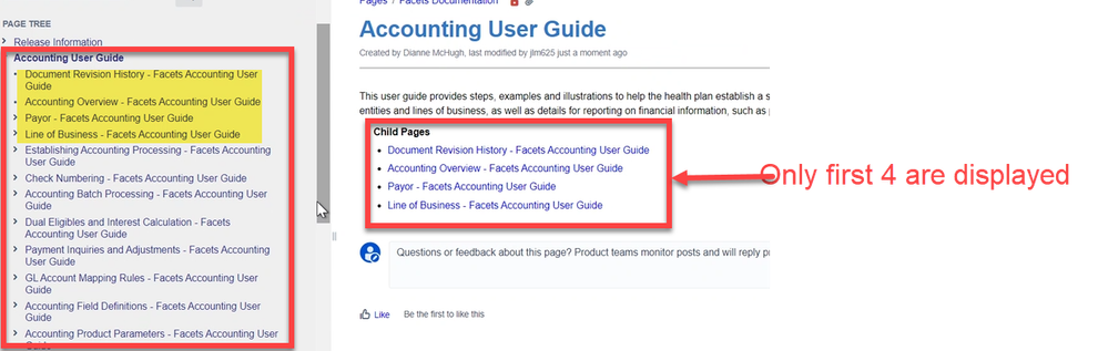

We are having issues with child pages that are displayed on parent pages in the Children Display macro. Regardless of the number of child pages, only the first four are displayed. We are using the default settings (we are not setting any limits).

does everybody see 4 children only on the parent page's macro output?
I'm asking because of a specific phenomenon:
As a Confluence Administrator, you'll see the complete page tree in the sidebar in any case. But on the page, you'll only see the macro output as a user. So if there are page restrictions on the pages 5-x and you as a user are not added to these restrictions, the macro will show you those 4 pages only. The users added to the page restrictions will have a different count of pages they see on the parent page.

Thanks @Nicolai Sibler. Everyone sees 4 children only, and it is present in all wikis spaces (we have over 100).

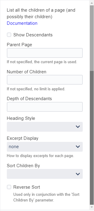

Can you share how you configured the macro ?
There is a Number Of Children Parameter that should be empty or may be set to 4 in your case.
Alan Vickers
July 29, 2022
Hi Florian. Thanks for the quick response. We are leaving the default settings:
