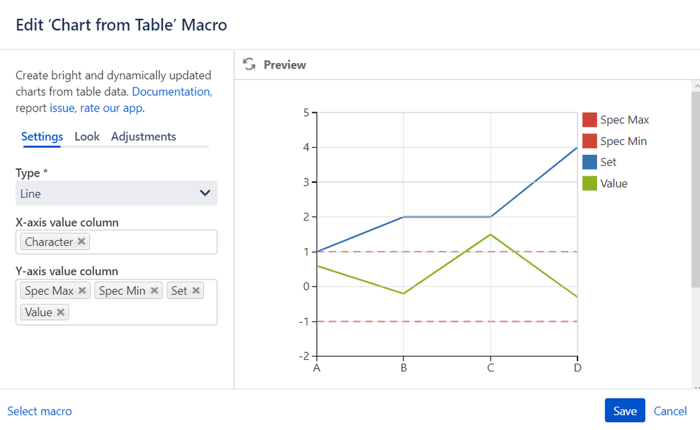

Hello allmighty Experts,
I have a problem!
I need to a plot showing that Value is in Spec for each Set.
CharacterSetValueSpec MaxSpec Min
A10.61-1
B2-0.21-1
C31.51-1
D4-0.31-1
Spec is always the same, so should show up as a horizontal line.
2023-06-09 14_50_01-dvfdvdfvd - WINTER Kai - IMS Nanofabrication GmbH Servicewiki Confluence — Mozil.png
However, when I have two rows corresponding to the same Set my Spec line is broken.

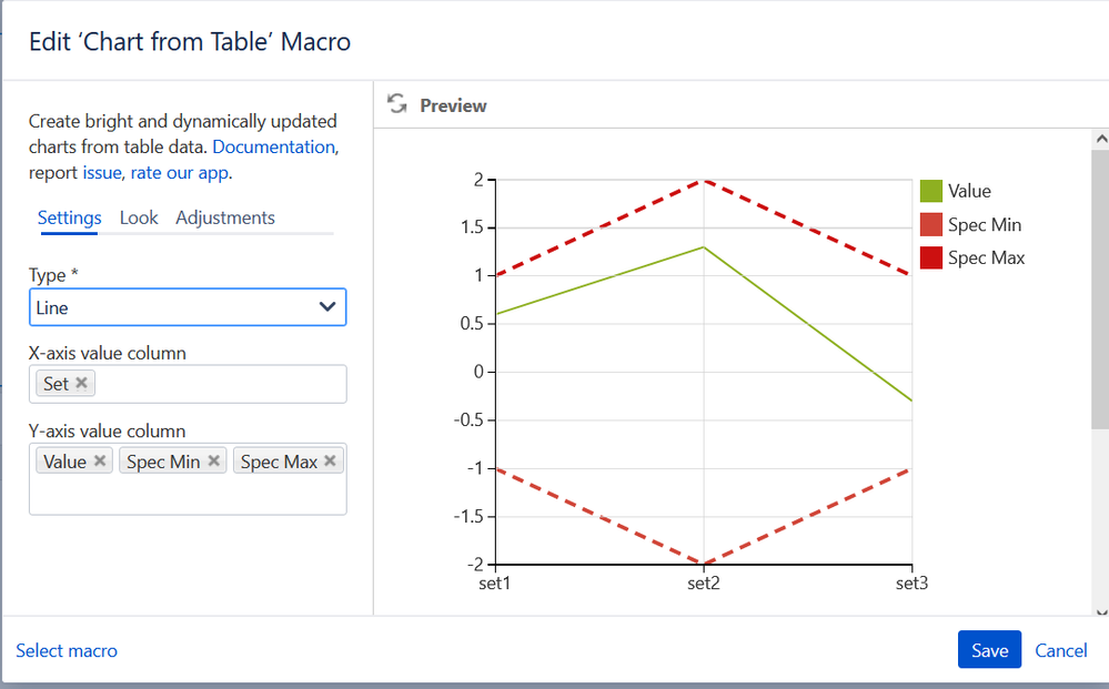

A10.61-1
B2-0.21-1
C21.51-1
D3-0.31-1
2023-06-09 14_48_18-dvfdvdfvd - WINTER Kai - IMS Nanofabrication GmbH Servicewiki Confluence — Mozil.png
Anyone has an idea how I could solve this? I often have multiple values corresponding to the same set.

Hi @Kai Winter ,
Seems that the behavior is correct: you can't have two identical numbers (values) on the axis. The graph is confused which "two" from which row we need to take.
In your Character column all your values are unique, maybe you can take them for X-axis instead of the Set column?

Kai Winter
June 9, 2023
The same happens if I call my Set a different way
2023-06-09 16_10_43-dvfdvdfvd - WINTER Kai - IMS Nanofabrication GmbH Servicewiki Confluence — Mozil.png
Also Spec Min takes the value -2, which doesn't exist in the table.

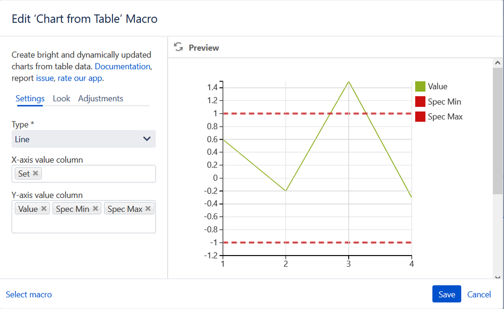

Kai Winter
June 9, 2023
Is there a way to plot horizontal lines in a line plot additonaly to the main data?

June 9, 2023
Your idea to plot horizontal lines for the line chart is correct: just to use additional columns with the same values.
