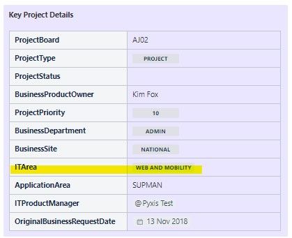

This is my page properties table with the key property highlighted:

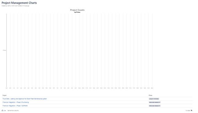

This is my page where i want the chart to sit. The report at the bottom is a replica of the page properties report that is sitting in the chart macro, filtered on ITArea:
The chart is not showing any data even though there are 3 projects in two different IT Areas.

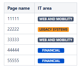

Here is your table:

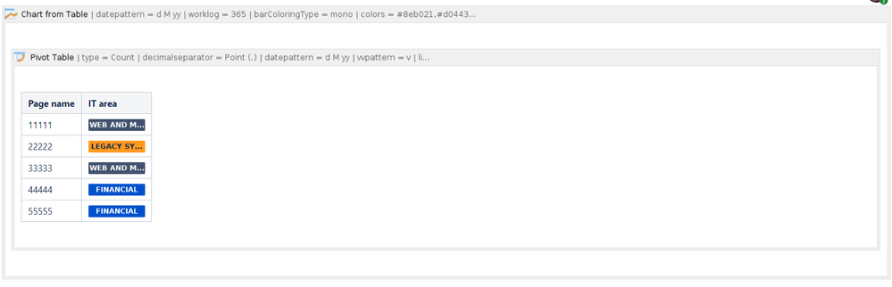

Let's wrap it in the Pivot and Chart from Table macros:

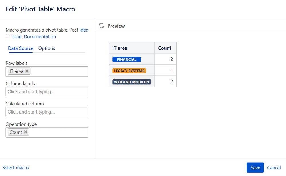

Kat 2.pngNow let's count how many statuses of each type you've got:

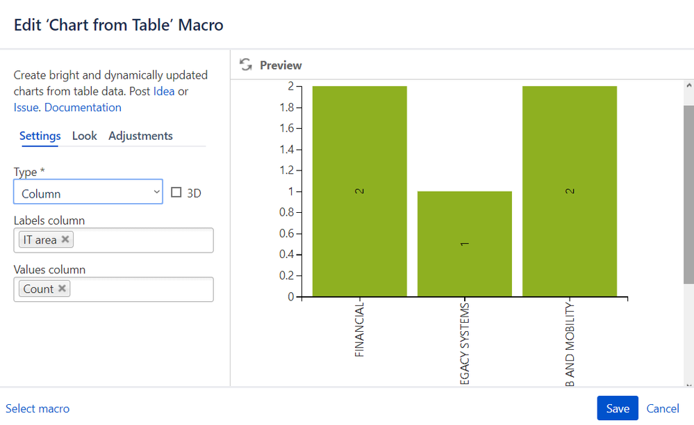

Kat 3.png The last step is to visualize the result:
