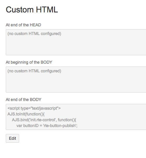

Just to be sure, I put that in the Custom HTML at the end of the body.  I did not restart confluence.  Here is a screenshot.Screen Shot 2017-11-07 at 9.47.34 AM.png
Davin Studer
November 7, 2017

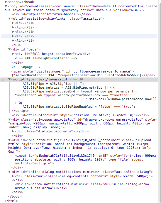

Hmmm ... It works on my install 6.4.2.  using the code above. If you open up your browser's developer tools (F12) do you see any JavaScript errors in the console ... especially when you enter edit mode.

Don't know why I didn't think of that.   Not seeing any of the code show up.   There is a javascript section earlier in the page, but I'm assuming you can have more than 1 code section in the body?
