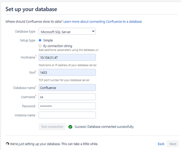

5. Next step screen, connect to database

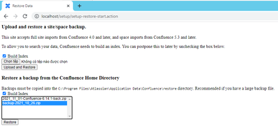

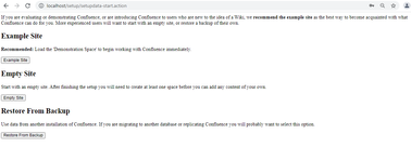

6. Import data using Restore From Backup.
Select backup zip file (backup from confluence system)
System still importing... I don't know when it done?
