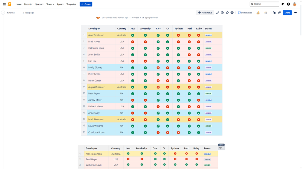

In general, macros tend to grab a bit of a page free place for the provided additional elements. For example, on the first screenshot the upper table is a plain table and the lower table is the same table but wrapped in the Table Filter macro with filters in the header. The page is set to fixed width by default.
As you can see, the upper table is a little bit wider because the lower one has an additional button on the right.

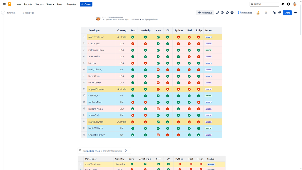

If you change the Table Filter macro settings and switch to the classical filtration panel, there will be no any additional buttons and the tables will look pretty the same:
