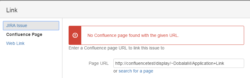

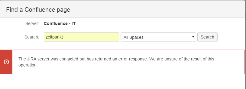

When trying to link a Confluence page to a JIRA Issue, it doesn't work. You can't search for a page with the 'Find a Confluence page' dialogue and when you insert a link to a Confluence page it says "No Confluence page found with the given URL.". However, I can mention JIRA Issues in Confluence without problems. It seems like the application link only works in one way.

2017-08-21 14_05_06-Find a Confluence page - NOWEDA JIRA Test.png2017-08-21 14_25_02-Link - NOWEDA JIRA Test.png

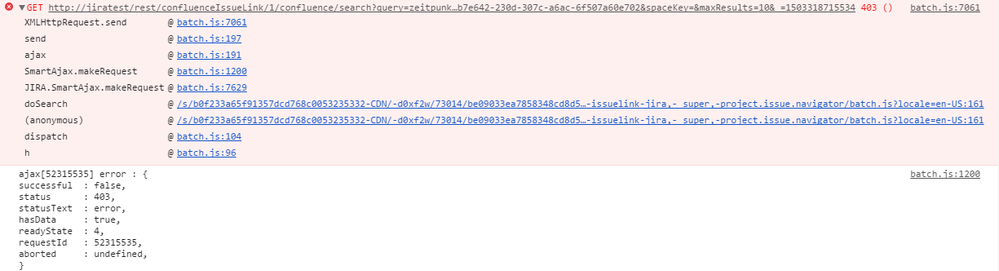

When inspecting with Chrome Developer Tools:
