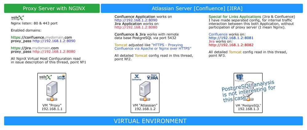

  • I have Confluence & Jira application installed on one single virtual machine
    with Centos 7 OS (Virtual machine - next it'll be just abbreviation VM).
  • Also for HTTPS proxy (let's encrypt ssl certs) created another one single VM with Nginx. All FQDN requests will be handling on this machine.
Take a look on this schema below:

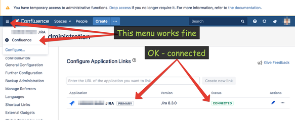

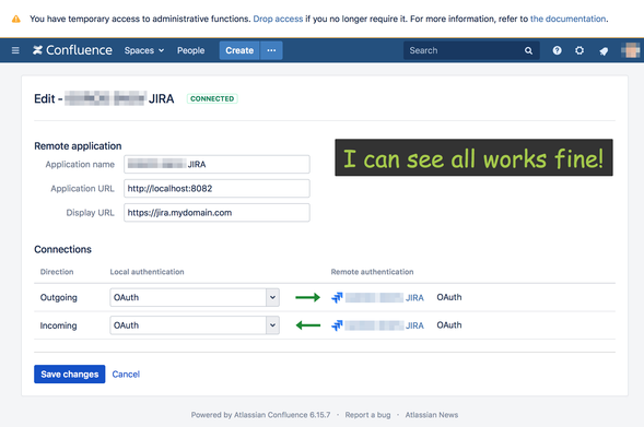

I did add Jira Application in Confluence panel Administration -> Application Links:

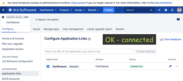

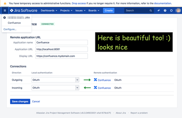

I did add Confluence Application in Jira panel administration System -> Applications -> Application Links:
2019-08-02_18-52-53.png-----

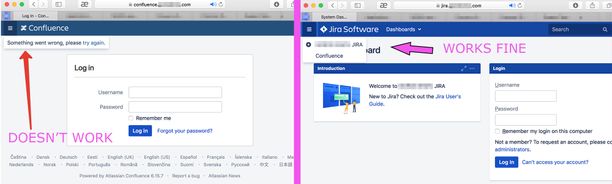

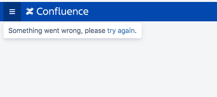

I faced up with an issue with interaction of this two application!

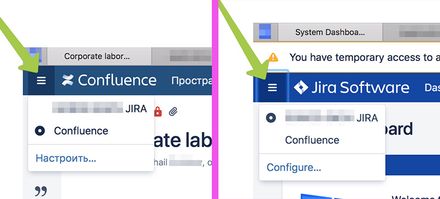

ISSUE №1  => When I am logged in, this switching between applications works well
But when I'm log out from Confluence, Confluence tell me Something went wrong, please try again. But when I'm log out  from Jira, button switch in Jira works well.

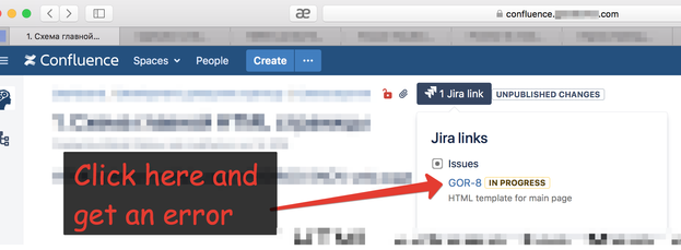

ISSUE №2  => When I'm log in Conflunce, link on Jira opening in modal window, but when I click on the ticket, confluence tell me:
The provided url is not included in the whitelist!
Any idea? What went wrong, where is mistake in both this issues?

  2. I still have an issue with button switcher. Navigator button doesn't work if the user is not authenticated. I see message "Something went wrong, please try again." I have find Trouble Ticket CONFSERVER-58238 here describing this issue, but I can see Affects Version/s: 6.13.0, 6.14.0, 6.15.2, but in my case, version is 6.15.7.
Somebody has any idea how to fix this issue?
Daniel Eads
August 7, 2019
Great find - given that 6.15.2 is affected and the ticket hasn't been marked as fixed, it's fair to say that 6.15.7 is affected as well. Watching the ticket is the best way to stay informed on progress (it will need to be fixed in a future version of Confluence).
There is a workaround posted on the issue:
Enabling Anonymous access in Global Permissions is a possible workaround, since this is caused by an unauthorized request. As long as the spaces don't allow Anonymous access, no content will be visible.

Daniel Eads
August 6, 2019
Hey Mikhail,
First of all, thank you for the very detailed writeup! I found it very easy to follow and determine the problem you're facing and have all the necessary information to recommend a fix.
So the short story seems to be that Confluence got confused with the different URLs in use and only added part of what you need to its internal CORS whitelist. Confluence and Jira try to manage this automatically when you add application links, so in most circumstances you wouldn't need to fiddle with the whitelist.

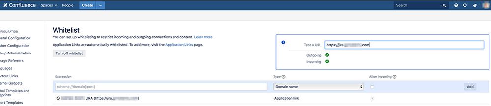

The application URL (localhost:8082) configured for the link in Confluence is different than what Jira's base URL is configured for (https://jira.mydomain.com). When Confluence went to add the application URL to the whitelist, it likely used the localhost value. This is mostly good because it's the proxy bypass you set up, but it's also not matching how Jira is trying to write its URLs. That's causing the problem you're seeing when it complains the URL isn't in the whitelist - Jira is using its base URL but Confluence doesn't trust that separate non-localhost URL.
So, the fix is that you'll want to add Jira's base URL to the whitelist in Confluence. We've got a KB article about how to do this here, but for your convenience I've copied over the steps:
  1. Go to  > General Configuration > Whitelist
  2. Enter the URL or expression you want to allow (https://jira.mydomain.com).
  3. Choose the Type of expression (for you it will be Domain name).
  4. Choose Allow Incoming if you need to allow CORS requests.
  5. Choose Add

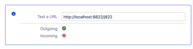

Have a run at that and see if the errors clear up! Newer versions of Confluence also have a test section on the Whitelist page that can help diagnose problems with particular URLs.
