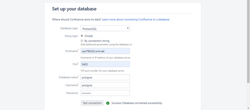

I would like to explain you some thing that maybe it's very important :
My server vps os is centos 7 :
I opened the port 8090 (confluence) and 5432 (postgres) and i use this url in windows to configure the installation because i do not have graphics in server .
Postgres : postgres (PostgreSQL) 9.2.24
Confluence: atlassian-confluence-7.3.3-x64.bin
the problem is the test succed can it be a chrome problem ? i tested with firefoox same problem also .

Thank you for your help , i appereciate your patience.

Hello @Tinker Fadoua
Really as you said , it was a system requirement , now every thing seems okay .
Thank you for your help and patience .
Regards
Karim
Hello @karim -Atlassway-. @Tinker Fadoua
Could you share how the issue has been solved? I have the same issue and the last message in the thread is like "thanks. we've solved it" - but how?
hello @Eugene Victorov
It was a system requirements problem, means not enough RAM Memory .
the problem is Out Of Memory.
regards
karim
