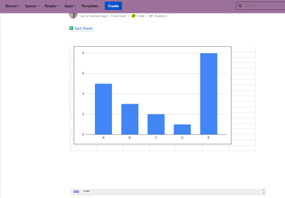

Hi @Blake Faulds
I was able to embed the google sheets, without problem
Just make sure that when you share this document, then it should have this on:get link.png
Let me know if that was what you wanted.
