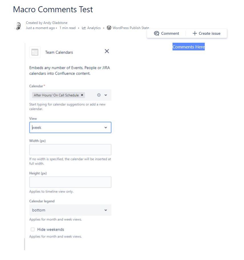

@Chelsea DeWall welcome to the Atlassian Community.
Regarding your questions:

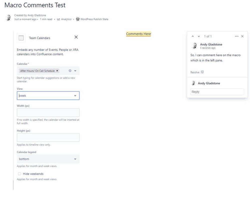

  1. Users cannot comment on a macro.
    1. You can use the layout button to set up your page with columns, embed the macro in one column and then a comment section in the other column. This way users can click on the comments section and leave comments on the macro.
  2. The only way to edit a page is to go into edit mode, unless users are commenting.
See screenshots below for how this would work. I hope this helps!
