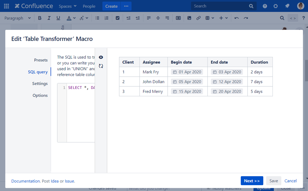

This use case can be resolved with the help of the Table Filter and Charts for Confluence app.

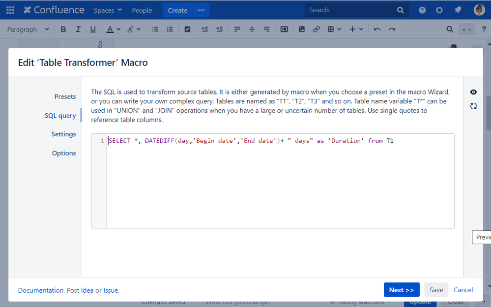

You can wrap your Pape Properties Report with the Table Transformer macro and enter the following SQL query:
SELECT *, DATEDIFF(day,'Begin date','End date')+ " days" as 'Duration' from T1

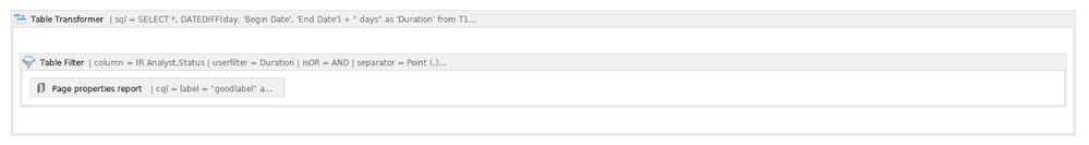

2) I also have Table Filter included to make it easier browse the files, my current page architecture looks like this:
2020-04 Confluence msr.PNGProblem is that the report filter to help browse the page now appears BELOW the list, the team would prefer to have it on top of the list (specifically once we have several hundred entries it would be very clumsy to scroll all the way down to the list to start a filter search.
Maybe you can help there as well. Other than that, thanks for the quick reply here!

Hello Matthias,
Let's try to replace that SQL query for the following:
SELECT *, ROUND(DATEDIFF(day,'Begin date','End date'))+ " days" as 'Duration' from T1

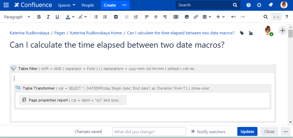

Regarding the second question, you need to wrap the Page Properties Report macro with Table Transformer at first and then add Table Filter.
