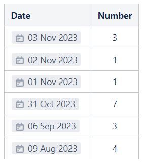

I have a simple table, as per the below:
The first part of my calculation, requires obtaining a count of the distinct dates. In my example below there are 6 dates, so that's my first item of data.
I then want to calculate the number of days between the minimum date and the maximum date. So, the minimum date is 9th August and the maximum date is 3rd November. I think that is 87 days.
So, what I need within a table transformer macro is some SQL to dynamically calculate the distinct number of dates, 6 and divide that by the date difference, 87. Here my answer would be 0.068.

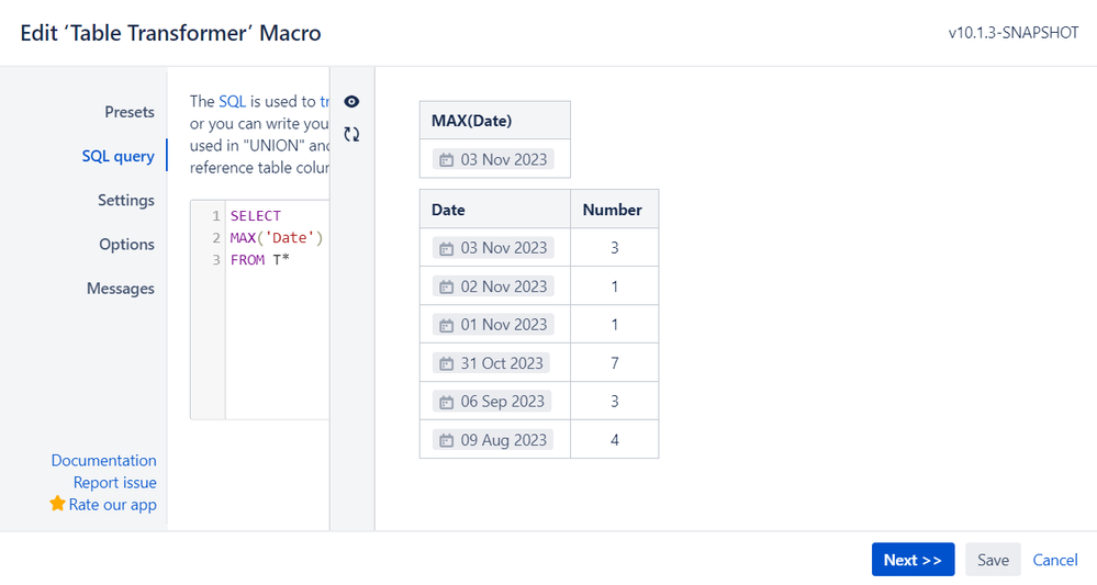

I'm falling down at the first part of trying to calculate this! When I use the following:
SELECT MIN('Date') FROM T*
It gives me a very surprising answer, 01 November 2023. Presumably based on 01 being the lowest number.
I don't understand this, and ultimately I need a complete solution to getting to that number of distinct dates divided by the min/max dates difference!

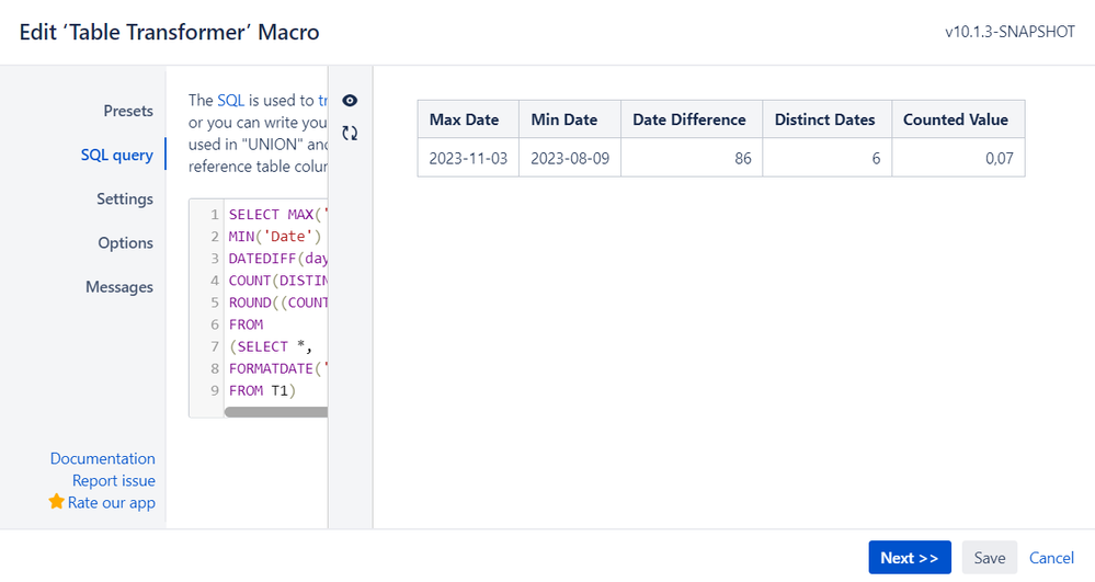

We may switch to the more simple "yy-mm-dd" format (please choose it in the Settings tab of your macro as well):
SELECT MAX('Date') AS 'Max Date',
MIN('Date') AS 'Min Date',
DATEDIFF(day, MIN('Date'), MAX('Date')) AS 'Date Difference',
COUNT(DISTINCT('Date')) AS 'Distinct Dates',
ROUND((COUNT(DISTINCT('Date'))/(DATEDIFF(day, MIN('Date'), MAX('Date')))), 3) AS 'Counted Value'
FROM
(SELECT *,
FORMATDATE('Date', "yy-mm-dd") AS 'Date'
FROM T1)

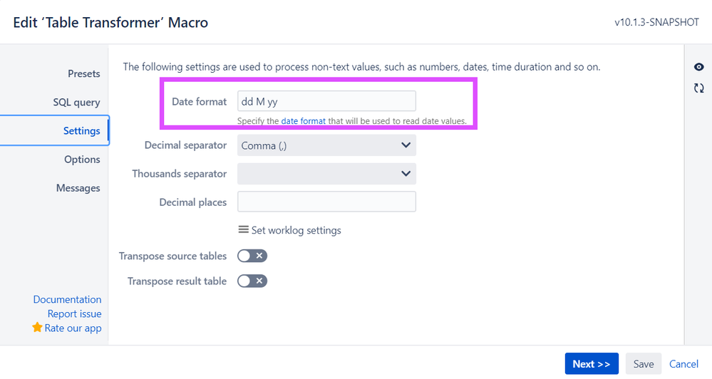

When you set the date format for "03 Nov 2023" and other dates, it should be "dd M yy" and not "d M yy" like I had at first.
The "dd M yy" format corresponds to the "03 Nov 2023" date and "d M yy" format refers to the "3 Nov 2023" (without nulls for one-digit days).
So, please type in the "dd M yy" date format manually and you won't need the internal SELECT - everything works correctly:

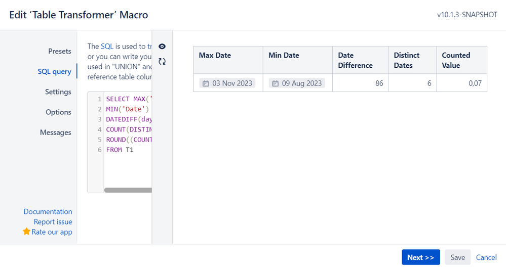

FROM T1
