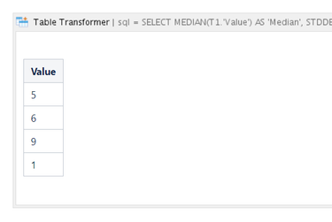

1. Place the macro outputting tables within the Table Transformer macro body:
2. Use the following SQL query (select the functions depending on what you'd like to calculate):
SELECT
MEDIAN(T1.'Value') AS 'Median',
STDDEV(T1.'Value') AS 'Standard deviation population',
STDEV(T1.'Value') AS 'Standard deviation sample',
VAR(T1.'Value') AS 'Variance sample',
VARP(T1.'Value') AS 'Variance population'
FROM T1
Where 'Value' is the label of the column from the source table with values, 'Median' and others are the labels of new outputted columns with results.
The result is as follows:
2019-12-17_15h45_49.pngPlease let me know if you have any questions.
