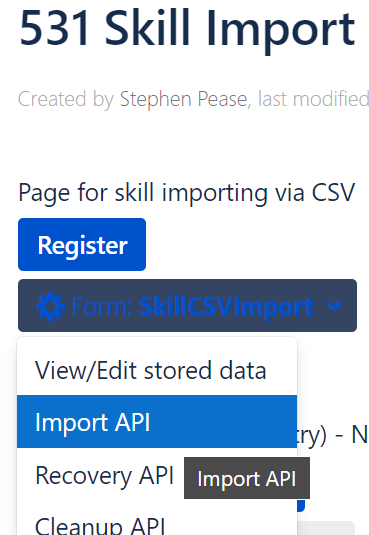

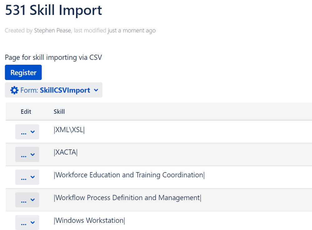

I went to the page and first selected "Cleanup API" which erased all the records. Then I followed the same process for importing the files, and after selecting "View/Edit Stored Data" I can see the whole list populated correctly like below:

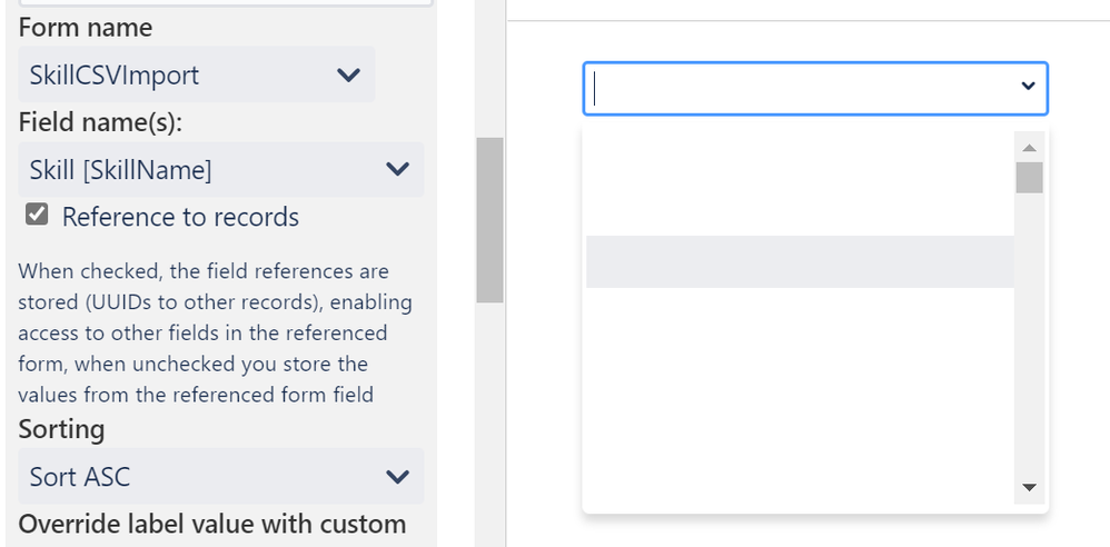

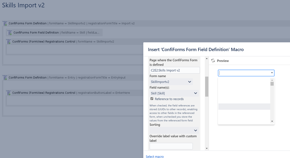

However, when I go back to my field that should contain this list, it is now showing blank. Strangely, if I scroll, it appears that the correct amount of records are there (it takes a long time to scroll and there are roughly 500 records, so it seems correct), however, everything is blank. See below:
Anyone have any idea what I might have done wrong? I appreciate any help. Additional info on the import is I am importing a single column CSV file using UTF-8 (and that is how the CSV was saved), but the list is correct on the page that holds the records, so not sure what is going wrong when linking the Confiform Macro so the Smart Multi-Select populates with the records (that are not blank). Thank you!

From what I can see on a screenshot is that you reference a "SkillName" field, but imported your data into a "Skill" field. So it basically does not have a "label" to show for the choices in the dropdown field and renders it as blank
Alex

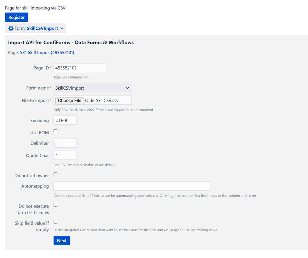

Here are the steps I am taking, and for good measure, I changed the column heading to SkillName in the CSV, but I imagine I am doing something wrong at the import step.
1. After clean up API, the records are gone, now I import the CSV
2. Select the CSV file to import and click next

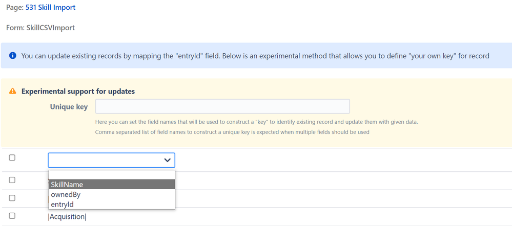

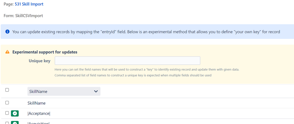

3. The next step is where I imagine I am doing something wrong. I am met with this window and normally I would just select the top left checkbox, which selects all records, then use the dropdown to select "SkillName" and import the records. I also normally de-select the "SkillName" header (I have also tried selecting it, but it just shows up as a record rather than a label or header).
4. Skills are imported along with the header (I can always remove it)
5. The list is still blank and the label has the strange "Skill [SkillName]" wording.
Any ideas where I am going wrong or how to fix the labeling if that's the issue? I'm at a loss. Thank you!
Hard to tell really... Doe it render the same on the form? (not in preview mode)
Unfortunately yes. It's identical, where it appears to be the entire list of 500+ records, but just blank. It worked so perfectly before and I'm just not sure what happened differently. I agree with you though that the "Skill [SkillName]" could be a problem, just not sure why or where to fix it.

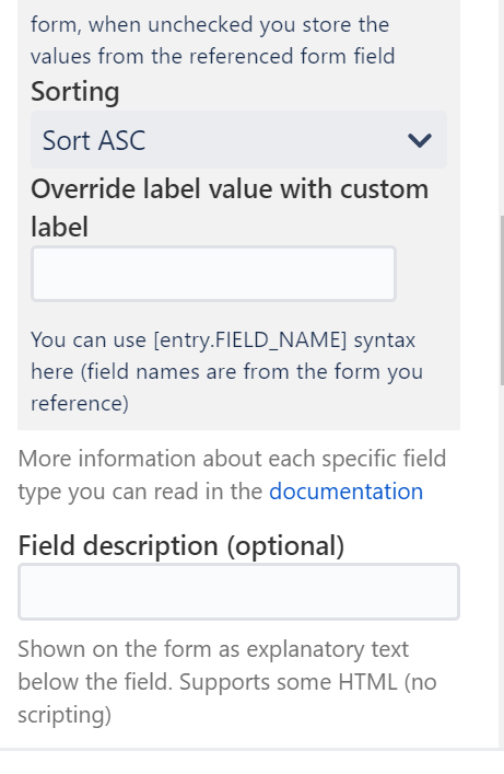

May I see a complete configuration of this "smart" field?
Is there anything in the "Override label value with custom label" parameter?
Sure, and no, everything else is default. I can't get a single shot of the whole thing since the window size is static for the confiform pop-up, but if you wanted to see any other fields, let me know.

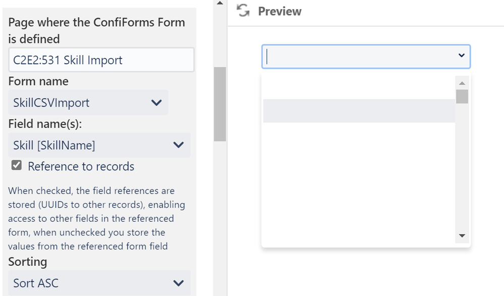

I even made a new page from scratch and followed the same steps and am getting the blank smart multi-select entries. I even went back to our original setup where the entry was on the same page as the import and the blank results still remain:
I can't figure out what is going wrong. Perhaps something in the label part when importing or it's somehow pointing to the wrong location? The things I know:
1. The list in the Confiforms multi-select have the correct amount of records, but they are blank
2. The import page is showing the records correctly by name
3. When I import, I am using the dropdown to select "Skill" as the defined name for the Confiforms Form Field Definition, and have the column title in the CSV labeled "Skill", though I do NOT select that single line, because when I do, it just imports the column header as a record along with the other skills and I do not want "Skill" in the list of records as a skill.
