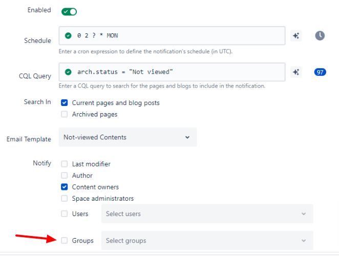

Here is how the configuration looks, it is quite self-explanatory. As you see you can select even multiple groups as recipients:
So, the bottom line is that if you can create a CQL search from your alert criteria, then it will just work!
