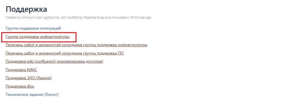

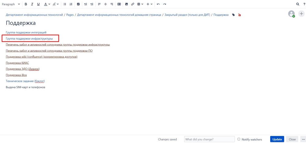

after migration Confluence Server to another server(centos->debian, version Confluence 7.19.2 was not change) the links are broken and turn brown, and when you click on these links, you are taken to the editing mode and not to the working page.Screenshot_3.jpg However, editing them is not available, and if you create the link again, it does not change.

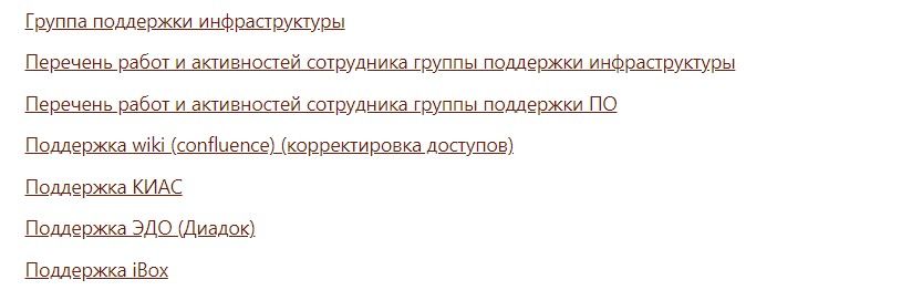

The macro include page also stopped working.There are no restrictions at the page or space level. Screenshot_4.jpg

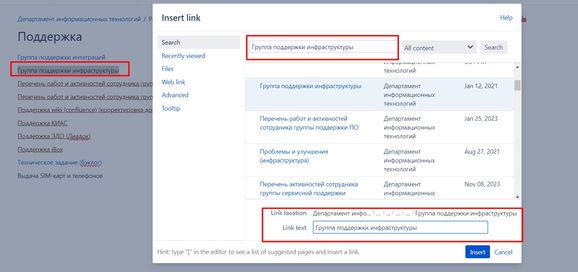

  • I'm editing an existing broken link, a try insert link by search pageScreenshot_5.jpg

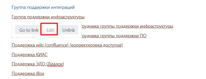

  • After my change, we see that the selected link is displayed correctly and click updateScreenshot_6.jpg
  • And link looks incorrect again

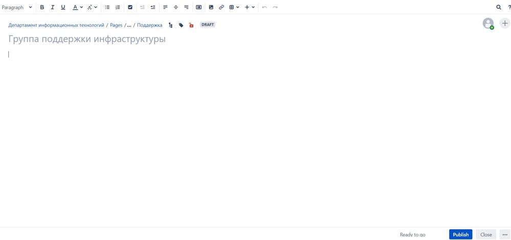

If i copy link and paste into browser or try follow link from the page i'll get link format http://confluence_url_name/pages/createpage.action?spaceKey=IT&title=%D0%93%D1%80%D1%83%D0%BF%D0%BF%D0%B0+%D0%BF%D0%BE%D0%B4%D0%B4%D0%B5%D1%80%D0%B6%D0%BA%D0%B8+%D0%B8%D0%BD%D1%84%D1%80%D0%B0%D1%81%D1%82%D1%80%D1%83%D0%BA%D1%82%D1%83%D1%80%D1%8B&linkCreation=true&fromPageId=16222877
And it's look like this
that is, it looks like it can't find this page and wants to create one with the same name
