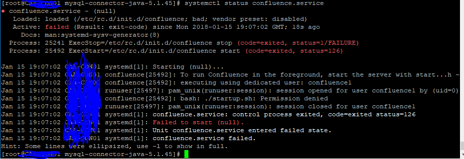

Hi Shannon - removed all confluence directories and reinstalled confluence from the start. Not a fresh server (that's my last play, don't want to have to do that yet).
the start up process tarts, it lets me connect up to my database, and on the next step (after testing DB connection) and hitting next - it gives me the same error! tried restarting confluence to no avail :(
When using systemctl to reload-or-restart, it gives me an error that when i use systemctl status gives me the below:

Shannon S
January 16, 2018
Hi Ilai,
The error you sent is showing "permission denied" which means the user still doesn't have the correct permissions to run Confluence.
I would recommend double-checking that the permissions on your Confluence Home Directory are set to the correct user, and then try to start Confluence again using start-confluence.sh as that user.

Shannon S
January 16, 2018
Sorry, you will also want to check your install directory for the correct permissions in addition to that.
I know these steps are outlined on the first article I sent you, but there appears to still be something wrong with the permissions.

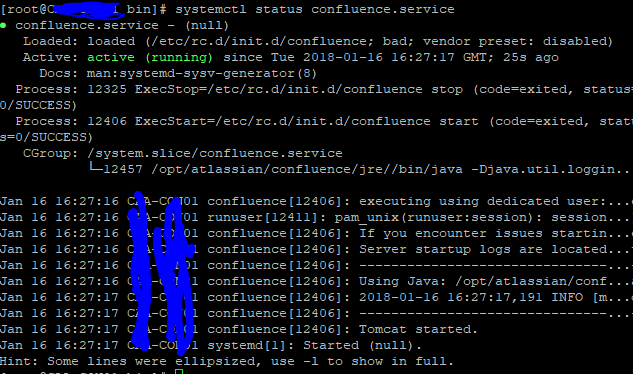

Ilai Schechter
January 16, 2018
Thanks Shannon,
Found that confluence was trying to execute as user 'confluence1', not 'confluence'. Changed the user.sh entry and got that working. All green now on the status of systemctl - but still getting the same error on the webpage.
All permissions were added as follows:
chown -R confluence.confluence /opt/atlassian/
chown -R confluence.confluence /var/atlassian/
chown -R confluence /opt/atlassian/
chown -R confluence /var/atlassian/
chmod -R u=rwx,go-rwx /opt/atlassian/
chmod -R u=rwx,go-rwx /var/atlassian/
And confluence shell started as confluence' user.
