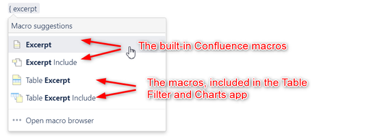

@chinmay shah, you are on the right track. However, the Excerpt source option is available starting from version 5.0.0 of the Table Filter and Charts app. Please, check the version installed in your Confluence instance. Also, please make sure you use the Table Excerpt and Table Excerpt Include macros instead of Confluence default Excerpt and Excerpt Include macros (there is no functionality to select the source in the built-in macros).

In case you have the Table Filter and Charts app installed, but can't find the Table Transformer macro or the Excerpt source option, you may ask your Confluence Administrator to update the app to the latest version because these features are available from version 5.0.0 of the Table Filter and Charts app.
In case you don't have this app and use the default Excerpt and Excerpt Include macros, there is no option to select the source in these macros:
