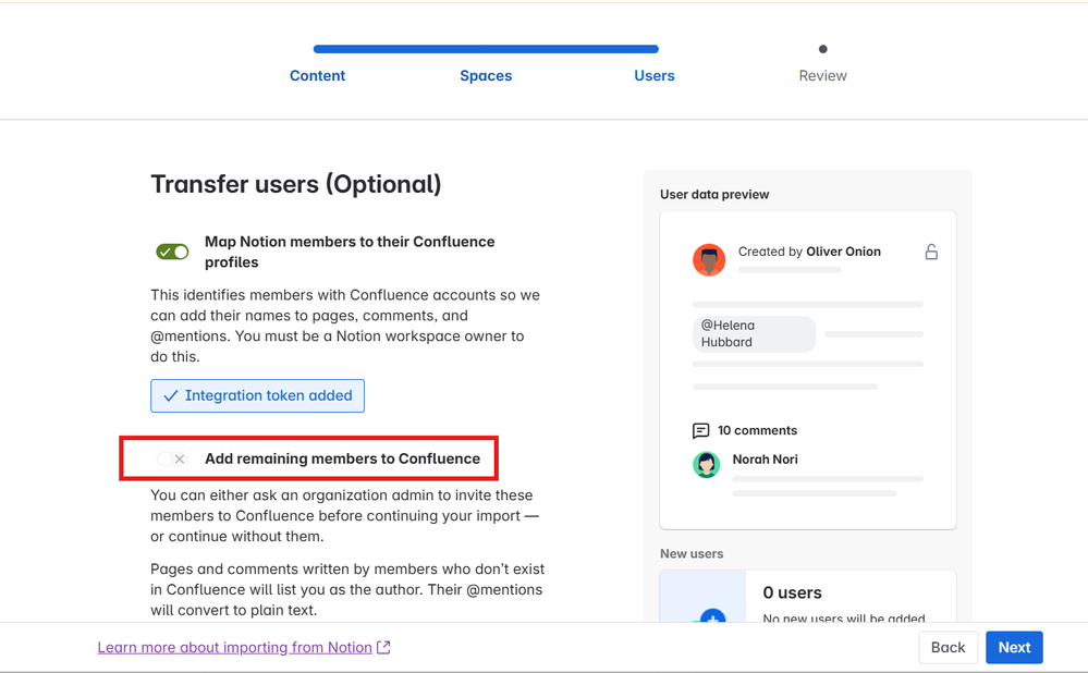

Manoj Kumar
May 16, 2025
@Tiffany Chung Could you please suggest me on this? Apart from above, I am not getting the option to copy the permissions and users. The member option is not enabling and permission option is not showing.Screenshot 2025-05-16 160902.png
