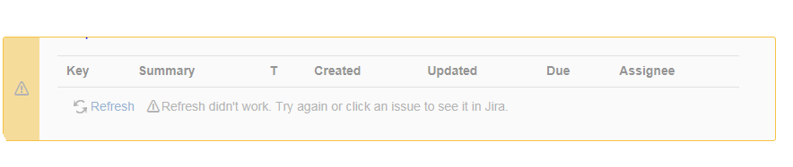

When running a query in a confluence (Jira bug list) from the Macro.
If using attribute issuetype, with any issuetype that contains a space the query does not run.
i.e. project = "Project Name"  AND issueType in ("Bug – Blocking", "Bug – Non Blocking") AND (status = Resolved OR status = Released OR status  = Closed)   will not execute, however if issuetype is "Bug" or "Task" it works fine. Seems like Confluence has a problem passing the query to JIRA if the issuetype has spaces....
help !

Hans Neitz
May 23, 2018
thanks for trying this out. I will open up a case.
more info: within the macro - it runs for me. this issue is once you exit the macro, and publish the changes, the area where the macro should run sits empty
Hans Neitz
May 23, 2018
oddly enough, when the issuetype is removed from the macro (where the issue type has a space) the macro runs successfully once published. If the issuetype is one word with no space it also runs fine once published.
Anyway, I will open up a case
