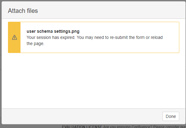

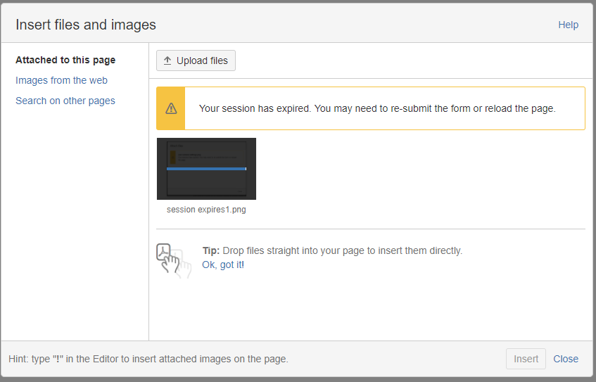

Hi,
I'm using Confluence 6.2.2 and when I'm trying to attach a file to a page, either in edit mode or drag and drop the attachment on the page, I will get a session expired message (See pictures below).
When I close the upload window, I don't have to login again.
Note that the time that I've been logged in does not matter.
What do I need to change to fix this?
Thanks,
Rudy
