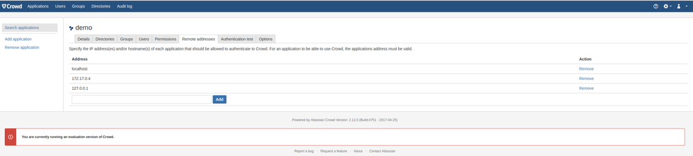

Check out this documentation:
https://confluence.atlassian.com/jirakb/connecting-jira-to-crowd-throwing-applicationpermissionexception-301662474.html
You should try to add this IP address to the remote addressed of the application on Crowd like this:
After that you should be able to login with your crowd user.
Regards.
