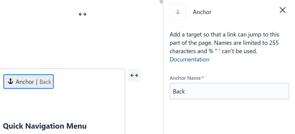

This is a Anchor:

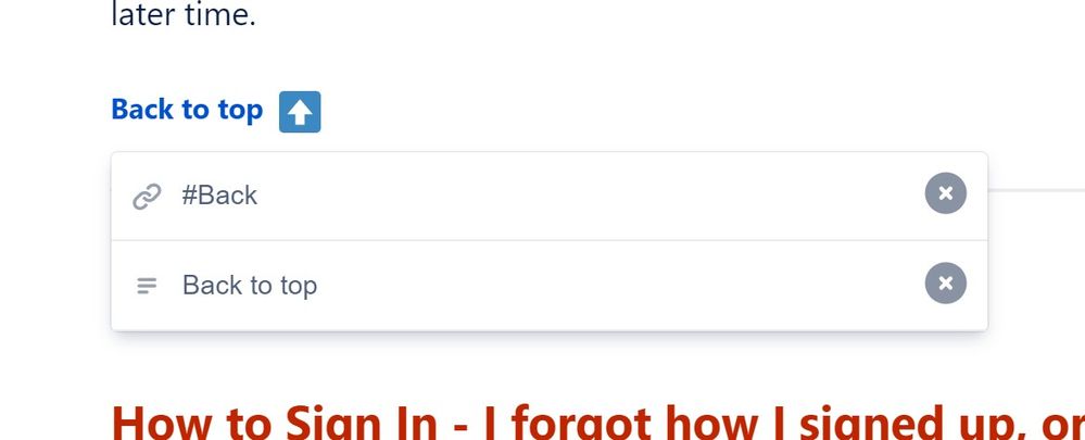

And This is what each link looks like:
