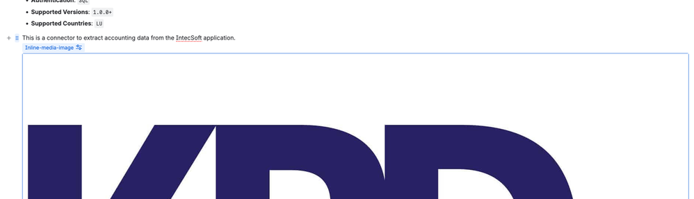

It works fine, but the problem is that the image is not in "thumbnail" mode, is too big or can't be expanded if i use the width property to reduce the size :

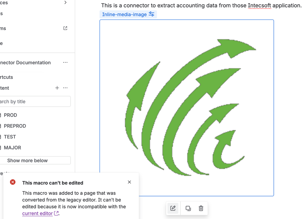

If I try to edit it directly in the page, I get this message:
"This macro can’t be edited.
This macro was added to a page that was converted from the legacy editor.
It can’t be edited because it is now incompatible with the current editor."

It seems i can't, this is what i see when i try to edit the page (even in "live doc" mode) :
And this is the error I see when I click the edit Image button.
