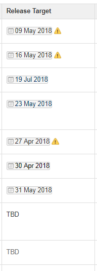

Thanks for the quick response, Ann!  After looking at the detail for the European time format, I'm not sure this is the same issue - although I guess the date format we are using is "European".  For us, it just looks like the value for "day" is the only sort criteria used.  See excerpt picture below.
I tried this on IE 11.0.9600 and on Chrome 66.0.3359.117 with identical results.

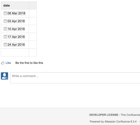

I don't think we should pursue changing the date format because mine is like yours and it works in ascending and descending order:Screen Shot 2018-04-24 at 2.06.47 PM.png
Since it fails in two browsers I don't think it's a browser issue. It works on my test instance so there must be something different between our setups.
To eliminate user installed add-ons as causing this, please try Disabling or enabling all add-ons (using Safe Mode). That will temporarily disable all user installed plugins and their macros so it is a good idea to do it after hours or during a maintenance window.

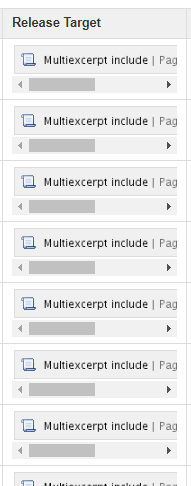

The table in question is actually made up of a series of multi-excerpt includes from various subordinate pages (see edit-mode picture below).  Could that level of indirection be a trigger?  Also, I've gone back and checked/expanded my test table and it does seem to work correctly today ( I swear it was not before, but anything's possible I guess :)).  So, it appears that straight dates will sort as expected, but these excerpt entries seem to have an issue.
Sorry for not identifying this detail before...
