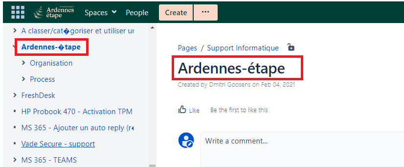

After updating Confluence, the accented characters in the articles title appear like question marks

Alex Bourdeau
January 16, 2023
To get around this behaviour add the following to the JVM startup options:
-Dfile.encoding=UTF8
More info here: https://jira.atlassian.com/browse/CONFSERVER-81330
Charles Focant
January 18, 2023
Hi Alex,
I'm not the one who installed and manage Jira and Confluence.
Maybe you could guide me. How do I add the option?
Is there a file somewhere where I need to add this line?
Alex Bourdeau
January 18, 2023
Hi @Charles Focant
Follow those instructions to add -Dfile.encoding=UTF8 parameter to your JVM startup
https://confluence.atlassian.com/doc/configuring-system-properties-168002854.html
Have a nice day !

Alex Bourdeau
January 13, 2023
Same issue.
It seems to be with the page tree macro. Other macros looks OK.

Charles Focant
January 4, 2023
@Benjamin
7.18.3 -> 7.20.1 -> 8.01 ->8.02
So I'm currently at 8.0.2.
Please note that the accented characters show wrong only in the left column, not in the articles.
I don't see why there would be a problem in the database. I'm a junior sysadmin and have little knowledge about databases and Atlassian Products. I was hoping someone could help me.

Charles Focant
January 12, 2023
As per https://confluence.atlassian.com/doc/troubleshooting-character-encodings-167194.html
I followed the link to the test: /admin/encodingtest.action
The test succeeded.
What does it mean?
I have the impression it is not an issue with the database but with the iframe on the left side of the page.
 TEST RESULTS:

Benjamin
January 12, 2023
It means it is something else. Do you have the same issue using another browser or if someone else tries to login? This can help with isolating the issue for support
Look at the end of the page on a link to raise a support request.
Thanks,
Ben
Charles Focant
January 13, 2023
Hello Ben,
I tried Chrome, Firefox and Edge, it happens on all of these browsers.
It also happens for other users.
There is no link to raise a support request, but I was told by the support that our 10 agents bundle does not allow us to open a support ticket...
