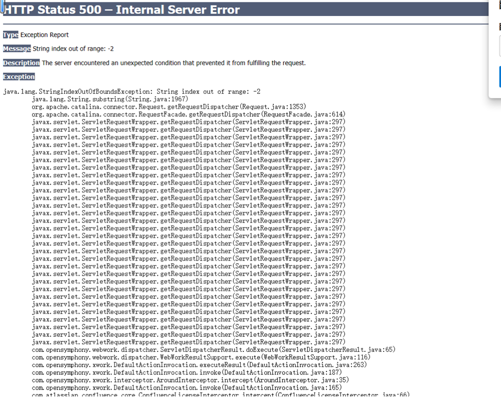

After the homepage of the browser is refreshed for several times, an error 500 is reported
wu_junjie
February 28, 2023
Previous operation: There was a power outage for a period of time before, the wiki could not start normally, the log was a plug-in error, so the database deleted the content in the "plugindata" table, and then cleaned up the files under /opt/atlassina/confluence/temp/* and var/atlassina/confluence/plugin*, and returned to normal after restarting the wiki
Now the access error is reported:
log:

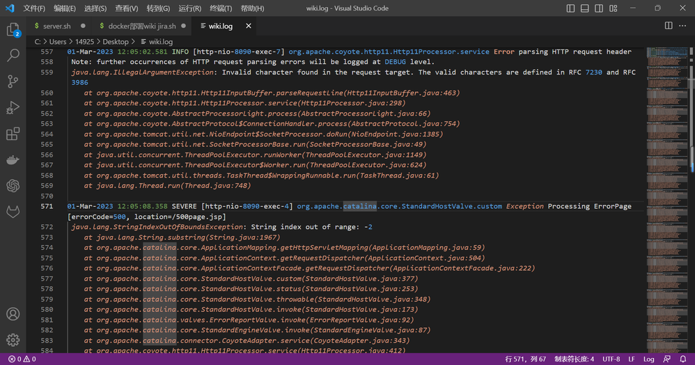

This question I know, the main one is:
01-Mar-2023 12:05:08.358 SEVERE [http-nio-8090-exec-4] org.apache.catalina.core.StandardHostValve.custom Exception Processing ErrorPage[errorCode=500, location=/ 500page.jsp]
java.lang.StringIndexOutOfBoundsException: String index out of range: -2
