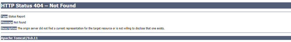

My confluence is using H2 databases, After an unexpected power outage I can't connect to my confluence, I also failed to link the database with DBVisualizer. It feels like it should be h2db.mv. db file is corrupted. Sadly I don't have a backup file, I repair the database with java -cp h2*.jar org.h2.tools.Recover, and then execute java -cp h2*.jar org.h2.tools.RunScript with the generated .sql file. I used DBVisualizer to connect the newly generated .db file successfully, I can see the tables and data inside, but after replacing the .db file with the new h2db, the http 404 error .mv.db file appears.Guys can anyone tell me what to do?

The h2 database is prone to catastiophic failure, on any form of system error (a crash or having the process killed without shutdown), as well as if it gets large.
This is exactly why all the docs say "for demo/dev/test purposes" - it's on;y usable for a system you don't care about losing.
The failure is usually simply that the data on the fisk gets truncated part way through, so you lose a huge chunk of the database, but it can be garage bytes written to it as well.
The recover tools can repair a truncation in the sense of they can work out how to end the loops to make the file readable again.  But it can't recover the lost data, that's gone.
I suspect that's what has happened to your database.  The repair might be a success as far as h2 is concerned, but a chunk of our data is gone, and Jira can't work without it.

Both my jira and confluence use the H2 database, but they are separated. Now the jira service is normal. My jira database had the same problem before but there are backup files that can be restored. Now the confluence database is damaged and there is no such thing as backup file,I only have the Confluence/database/h2db.mv.db file
Nic Brough -Adaptavist-
August 30, 2022
Yes, they will be separate - the h2 database is physically a set of files in the <application home>/database directory.  The installers create them when you ask it to use the embedded database.
Without a backup, your Confluence has gone I'm afraid.  There's no way to repair content that just isn't thre in a h2db.mv.db file.
