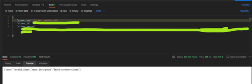

@Oliver Siebenmarck _Polymetis Apps_  Now I am using the different approach. My requirement is that I have organization ID and API token and I want to use organization API but I don't have access token how can I create it I tried but it didn't work I am linking the picture. Can you please help me with that?
I am giving organization Id in place of client id and API token in place of client secret
