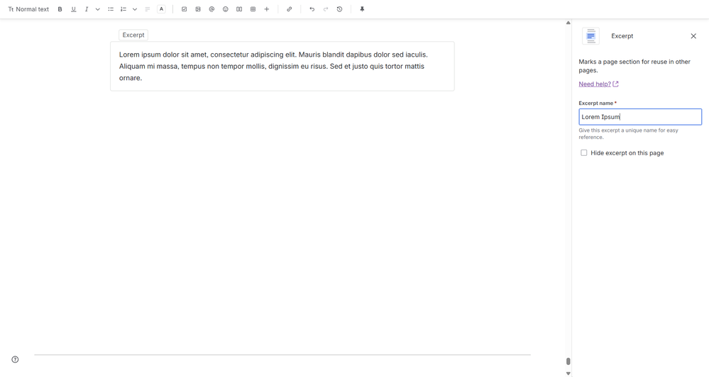

Is there a easier way to edit the name and content of these, than going on every singe one, edit the name and have the side window open and close over and over and over and over again?

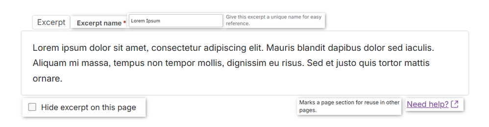

I would love if for example it was not a pop-up/side window that opens but the name above the excerpt edit ready and a checkbox directly below or smth like that.
Like this for exsample:
There is no need for this:

BTW: I had some fun and added a really quick mockup how it could easily look like (in my eyes) without sacrificing usability.
