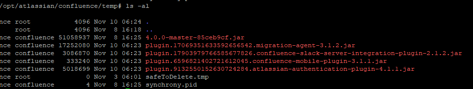

Is it in your case also given that the PDF is correctly stored in temp folder (despite the UI is showing an error) as documented in this bug?

The temp folder does not contain the PDF:
Untitled.pngas for the logs, this is the only log I can see:
