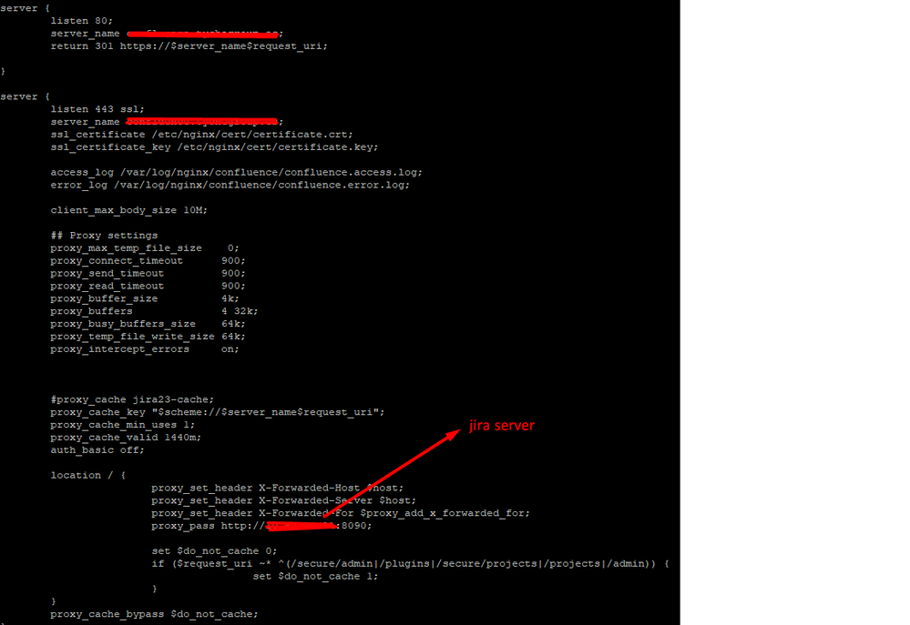

Confluence shows Error 502 when opening the url.
I have a server for jira, one for confluence and one for the database.
port 80 configuration is used for jira and port 443 ssl for confluence.
the servers are ubuntu 18.04 updated to date and jira version 8.2.4.
my question is:
  1. Is there an update that is affecting?
  2. Does any update affect the permissions level?
  3. Did an update make a change to the configuration parameters?
confluence server configuration:

Hi @tychegroup
Use the below Configuration and let me know it it works
server {
     listen [::]:80;
     listen 80;
     server_name your-site.com www.your-site.com
     location / {
         return 301 https://$server_name$request_uri/wiki;
server {
     listen [::]:443 ssl http2;
     listen 443 ssl http2;
     server_name your-site.com;
     ssl_certificate /path/to/fullchain.pem;
     ssl_certificate_key /path/to/privkey.pem;
     location / {
     location /wiki {
        client_max_body_size 100m;
        proxy_set_header X-Forwarded-Host $host;
        proxy_set_header X-Forwarded-Server $host;
        proxy_set_header X-Forwarded-For $proxy_add_x_forwarded_for;
        proxy_pass http://localhost:8090/wiki;
    location /synchrony {
        proxy_pass http://localhost:8091/synchrony;
        proxy_http_version 1.1;
        proxy_set_header Upgrade $http_upgrade;
        proxy_set_header Connection "Upgrade";
Also, you may need to change the server.xml file context path to /wiki and add the below
secure="true" scheme="https" proxyName="your-site.com" proxyPort="443"
Let me know if this works!!

tychegroup
January 17, 2022
Hi @Pramodh M
question, the port 8090 has to be open (listening) in the server?
Pramodh M
January 17, 2022
@tychegroup
Yes that should be open and nginx configuration is on same server where confluence is running

tychegroup
January 17, 2022
Hi, Laura Holton
thanks for your answer.
the first link does not apply, apache has not been updated, check the update history and apache does not have any updates.
the second link I don't have any errors in the catalina.out.
In confluence server i have an error:
2022/01/17 17:56:43 [error] 1216#1216: *4803 connect() failed (111: Connection refused) while connecting to upstream, client: xx.xx.xx.x, server: confluence.mydomain.es, request: "GET /favicon.ico HTTP/1.1", upstream: "http://xx.xx.xx.xx:8090/favicon.ico", host: "confluence.mydomain.es", referrer: "https://confluence.mydomain.es/"
SERVER
