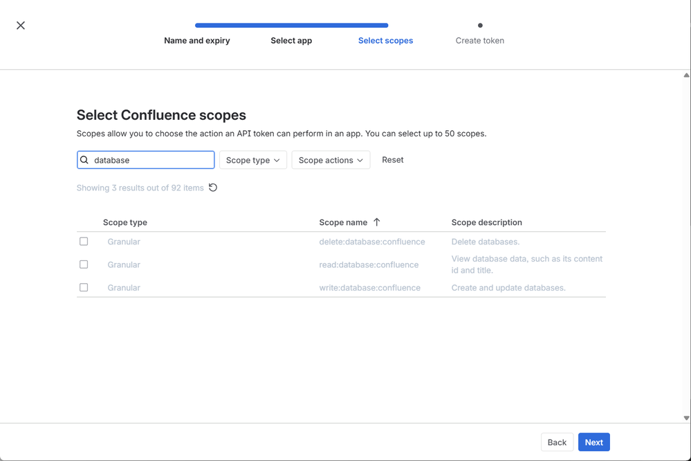

Hi @Alice Gu ,
I'm assuming you've referred to the following docs when it comes to creating databases with API: https://developer.atlassian.com/cloud/confluence/rest/v2/api-group-database/#api-databases-post
I haven't used the API for databases for a while, so have you checked which scopes is the API token using? Generally speaking, easiest way would be to use API token that can be generated via your profile https://id.atlassian.com/manage-profile/security/api-tokens or use Service Accounts.2026-06-30_09-52-24.png
Please check how things look with basic auth to see if that will work (if, potentially, something is wrong with OAuth 2.0).
